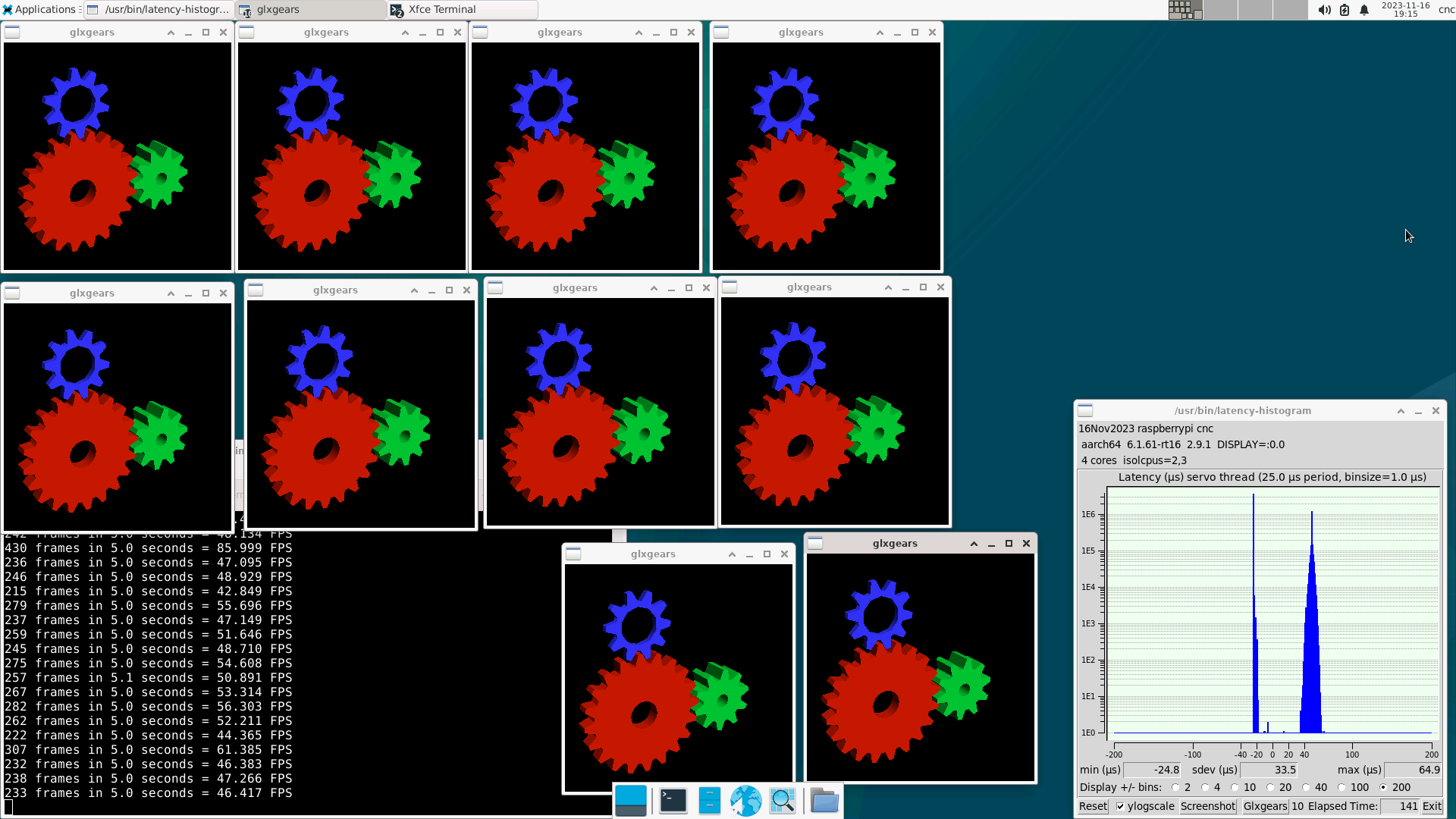

Replied by rodw on topic Comparison between Raspian 12 Bookworm on Raspberry Pi 4 and Raspberry Pi 5
Not me....
But....
I have synced my repo with upstream and they say the pi5 is supported now in the image builder we use.
I am building an image for the Pi5 as we speak.
The kernel built OK but I may have had an error building the root file system. Checking again.
If I have any luck, I will share a file.

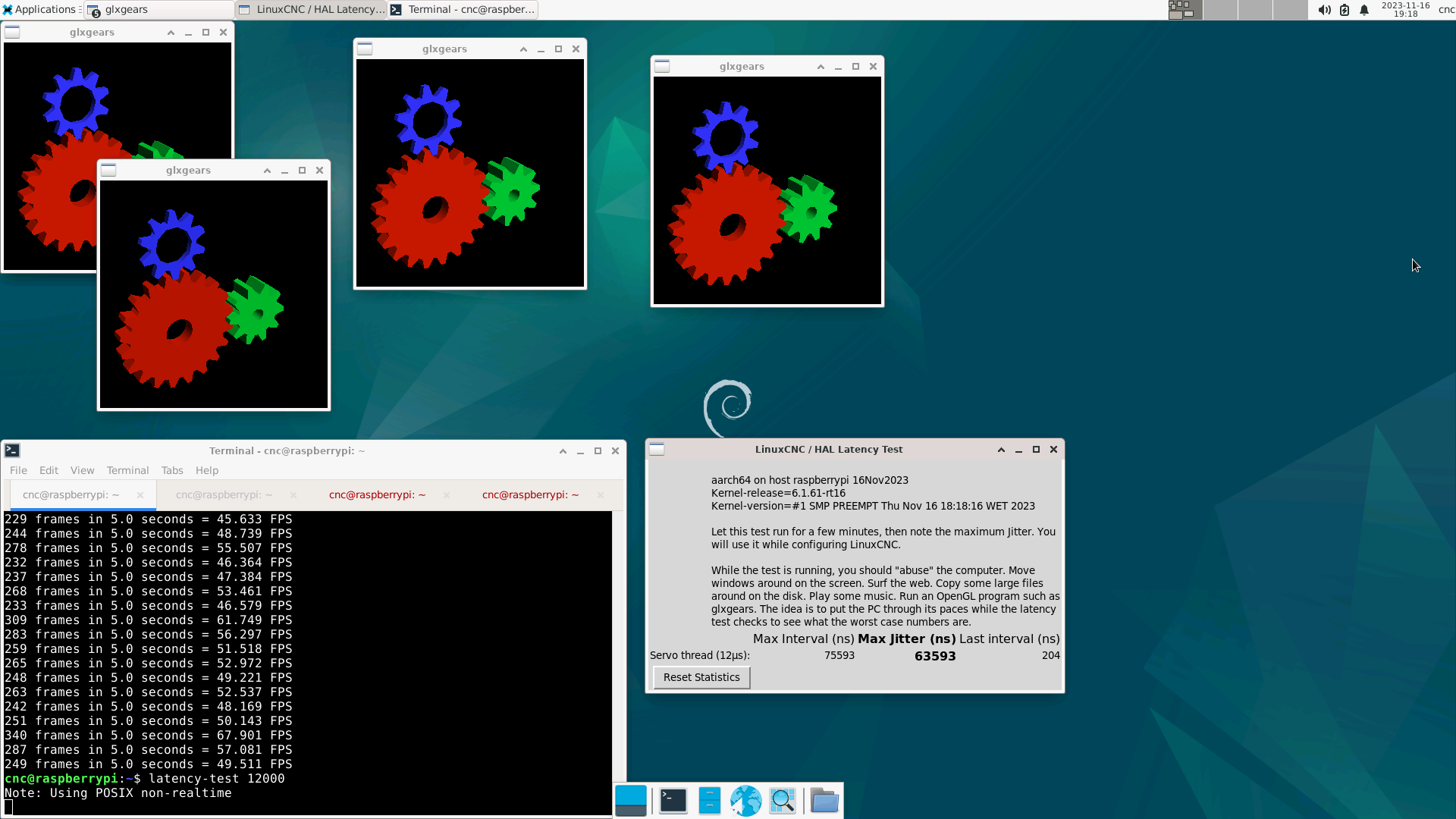

I have uploaded an image for the Raspberry Pi 5 here:
drive.google.com/drive/folders/1B29ewKVL...0QJGj?usp=drive_link
The RT kernel and the headers are available in the kernel sub folder. You could try installing both with dpkg -i on an ordinary image.
Please let me know how you get on.
Note the Linuxcnc repos are set up in your sources. (I hope)

16 Nov 2023 09:44 - 16 Nov 2023 11:30 #285625
by danielfmo
I merged your master branch into the linuxcnc-2.9.1 and updated the kernel hash and patch to 5_6.1.59-rt16.
Kernel gets into gets into a "running /scripts/local/block" loop and the rootfs fails to build.
Replied by danielfmo on topic Comparison between Raspian 12 Bookworm on Raspberry Pi 4 and Raspberry Pi 5
I tried that image and it does not boot in a rpi5, in fact there are no bcm2712-rpi-5-b.dtb file being generated, so I'd assume that 5_6.1.54-rt15 does not support the rpi5.Cornholio post=285614 userid=35653
if you use the commit we have been using it wont boot, if my experience is anything to go by. I'm trying to build natively with the 6.1.y branch
I hope it does now. There isn't a later PREEMPT_RT merged into their kernel.
Its possible if you accepted the defaults you built a 4b kernel
You have to run menuconfig as it was configured to build a kernel for the 4b/400 with a saved defconfig
chroot: failed to run command ‘/debootstrap/debootstrap’: Exec format error
make: *** [Makefile:157: rootfs] Error 126
Kernel built with latest 6.1.y commit with rt16 patch does boot with previously shared bookwork image.
