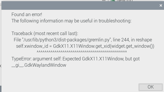

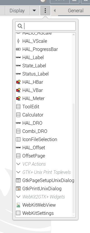

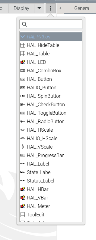

Seems like some GladeVCP widgets are not working on Bookworm yet as Wayland is used instead of X11. Gremlin is throwing errors and some others like Actions are not able to initiate.
Gremlin, none of the HAL Actions and some others are not available in the Glade widgets list.
Has anybody else encountered some issues with the GladeVCP widgets as well?
Piet

The reason all of my images and ISO's run XFCE is that it is an X11 environment. There is a way to tell Wayland how to deal with X11 via an environment variable but I can't remember how.
I have no idea if this will work or not, but could you please try this Pi5 image I have just built using the same environment as we used for the official pi4b image on the Linuxcnc downloads page. It uses XFCE.
drive.google.com/file/d/1H_q0Ra-27ZDOhqu.../view?usp=drive_link
The other problem child I have encounted in the past was VTK was missing in the Raspberry repos but I see now it is available in Debian. It was a 5 hour compile on a pi4b. (Maybe that was for QTPYVCP who don't offer pi packages in their repo.)

Debian has some info here.
wiki.debian.org/Wayland#Xwayland
Or if you start with raspios lite (no desktop) and install xfce as the desktop enviroment.
or.. as per help.realvnc.com/hc/en-us/articles/14110...-and-RealVNC-Connect
Raspberry Pi 4-5: This device defaults to using Wayland (wayfire) on Pi OS Bookworm, however it is possible to switch to X11 by using the command line raspi-config utility, under Advanced Options -> Wayland. Our initial testing indicates that RealVNC Connect functions as expected in this mode.

Thanks Rod, you pointed me in the right direction and there was an easy fix
here
. Sorry I don't have Pi 5 yet to test your image.
