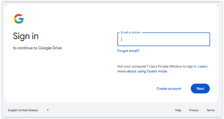

- scotth
- Posts: 242
- Thank you received: 61
06 Apr 2025 13:55 #325816
by scotth
Replied by scotth on topic Linux_Mint_22.1_LinuxCNC_2.10.iso
- Posts: 21738
- Thank you received: 7428
06 Apr 2025 16:49 #325822
Replied by tommylight on topic Linux_Mint_22.1_LinuxCNC_2.10.iso
Should be fixed now.
Sorry.
Sorry.
