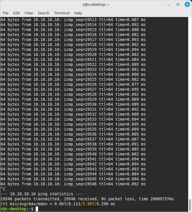

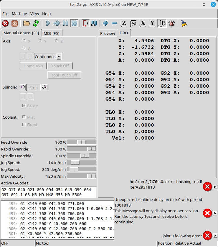

Ping times look super other than the glitch, also on the latency test.
Could it be a glitch in 6.13.

Try an add on network card, or a USB to LAN adapter.
16 Apr 2025 12:41 - 16 Apr 2025 12:43 #326450 by scotth
Replied by scotth on topic Linux_Mint_22.1_LinuxCNC_2.10.iso
I was running this computer over a year on 2.9.x with no problems.
Anything is worth a try, new Intel card on order. It should be here tomorrow.
