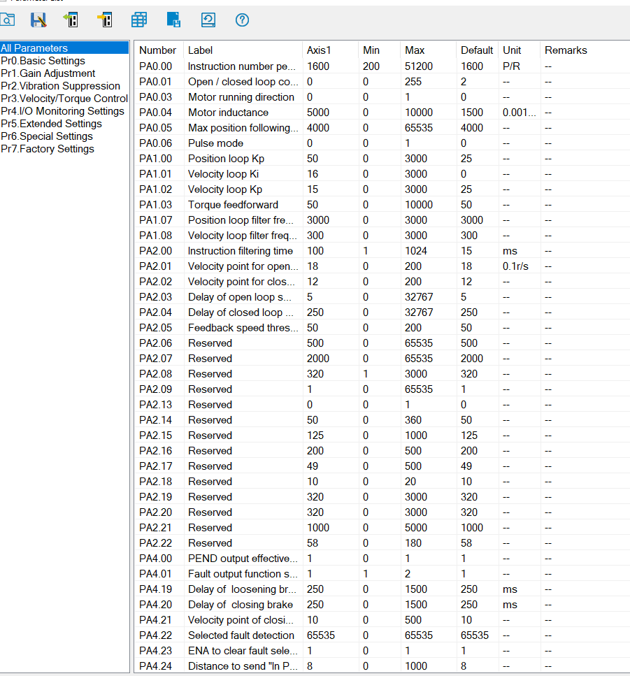

Okay so i confirmed that 1600 is the number, but this just makes me question what the micro steps are doing. Its clear i don't know what the step/rev actually translate to.
I guess i am just looking for what the optimal dip switch stetting is for my setup and what this number should be.
This software seems to have a decent scope as well. Is there any reason i shouldn't use this to tune the PID and get it close before moving to LCNC? It just easier when its all on the test bench. I know alot of wiring noise factors in it final resting place will make a difference but could i get it close here? or would the new environment completely change the PID settings?

update,
I changed the number to in the driver gui to 1800 and upped the 'stepsPerRev' variable in the Arduino code to 600 and its working great so far. This is with the dip switches set at default.
If i switch the dip switches to 1600, the value in the gui updates to 1600. So this leads me to believe the dip switches set the steps per revolution. in retrospect i guess its obvious.
I am going to leave it as is because its clean and now going to switch the control to closed and see about tuning in the PID before i reinstall it on the CNC. unless thats not a good idea.

20 Apr 2025 03:54 - 20 Apr 2025 03:56 #326745
by spumco
I think the drive's following error setting is PA0.05, which is factory set to 4000 counts before an alarm. In your screenshot it looks like that parameter is "Max position following..." and I think the cut-off text is "...error." If so, that's the number of counts the motor can be out of commanded position before the drive faults.
Which means:
1 - the encoder PPR setting in the drive is correct (it's looking for 4000 pulses, which is what a 1000-line encoder produces in quadrature), and
2 - the motor can be a full revolution out of position before the drive faults.
Set the following error counts to 200 for now, and you can adjust that up a bit if you start getting drive following errors under normal positioning moves. Frankly, with as low a torque load on the motor as I expect you could probably get away with 50 counts (or less).
Regarding your earlier question about the encoder... the motor datasheet indicated a 1000-line, 4000-pulse encoder is on the motor. If the drive wasn't programmed to expect a 4000-pulse encoder the motor/drive pair would act really wonky. Those drives are usually set to match the motors, but it doesn't hurt to check.
Replied by spumco on topic Determining Angular Scale - Help w/ Microsteps
I'd suggest leaving the PID settings alone in the drive for now.
Which means:
Last edit: 20 Apr 2025 03:56 by spumco.

20 Apr 2025 15:26 #326768
by notJamesLee
Replied by notJamesLee on topic Determining Angular Scale - Help w/ Microsteps
thank you!
I did find the 'encoder resolution' in the GUI and it was at 4000. Probably a dumb question but since we adjust the steps/rev to cleanly be divisible by 3 do we have to do something similar here? I again dont think i understand what encoder resolution means, what are the units of this?
ill hold off on any pid tuning for now ill just update the error readings and reinstall it on the machine and start tuning it there.
Thank you all again for sanity checking and showing me the way!
