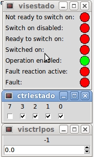

Hi everybody,
I've achieved some results!!
I can communicate with the drives in RT and even I've created some pyvcp to command position, to see the current state and to change the controlword
For coding the state depending of the first 7 bits of the statusword (6041) I've created a small function and installed it with comp
Next steps: Try with 4 drives and implements a delta kinematic!!
I can share all the codes if you need them!
Best Regards,
Nacho
