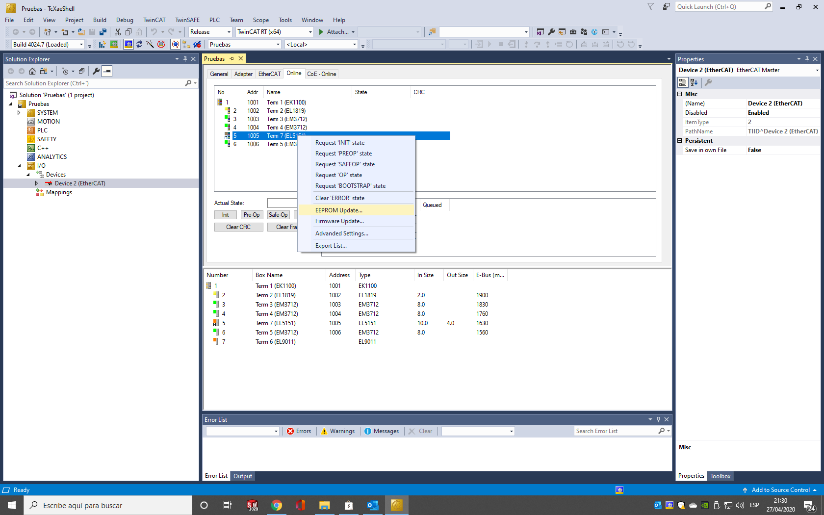

27 Apr 2020 19:47 #165861 by chimeno
Replied by chimeno on topic Ethercat HAL driver
hello @CORBETT,
I am attaching a new screenshot in another easier way to write in the eeprom, I hope you are lucky with the project
Greeting
Chimeno

I kept working over and over on TwinCAT 2.11 to get the ethernet card working and never could, but I downloaded TwinCAT 3.1 and it loaded the intel based ethernet card on the first try. I had already checked Beckhoff's website to make sure the ethernet card was compatible, but it just would never work in TC2.
So now I can see the EL5151 terminal in TwinCAT 3 config mode, but I am not quite sure what to do. I had read so much about TC2 that I am lost in TC3. I am just glad to finally see the thing show up in TwinCAT so I can try to get it working.
@ chimeno Albert, I will have to go back and review all that you stated in the past since I can finally see the terminal in TC3
