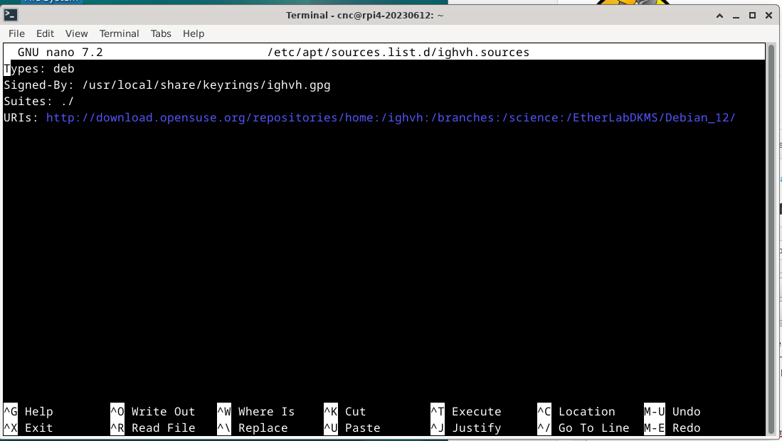

09 Aug 2023 10:41 #277417
by Psylocke
Replied by Psylocke on topic Ethercat installation from repositories - how to step by step
Hi Rodw,
I tryed the steps in the update post. Everythings looks fine till the install ethercat-master.
After 'sudo apt install ethercat-master' i get E: Unable to locate package ethercat-master.

09 Aug 2023 11:33 #277426
did you do sudo apt update?
What distro are you using? Bookworm? or another?
Replied by rodw on topic Ethercat installation from repositories - how to step by step
Did you create the /etc/apt/sources.list.d/ighvh.sources file?Hi Rodw,

09 Aug 2023 12:58 - 09 Aug 2023 13:01 #277433
by Psylocke
Hi Rodw,
Thank you for the very fast respond, i've been struggling for already more than a week to get a working rpi4+linuxcnc+ethercat. I did this several times with several distro's ans several notes. The rpi4 with linuxcnc under -rt is running, installing the needed ethercat despite without result. As i want to retrofit a 3+2 axis milling machine i want to use more profession drives with ethercat.
So here is the info:
Yes, i created the /etc/apt/sources.list.d/ighvh.sources file. I copied the shown data as instructed.
Raspberry Pi 4 Model B Rev 1.5
Linux rpi4-20230612 6.1.0-10-rt-arm64 #1 SMP PREEMPT_RT Debian 6.1.38-2 (2023-07-27) aarch64 GNU/Linux
PRETTY_NAME="Debian GNU/Linux 12 (bookworm)"
NAME="Debian GNU/Linux"
VERSION_ID="12"
VERSION="12 (bookworm)"
VERSION_CODENAME=bookworm
ID=debian
HOME_URL="www.debian.org/"
SUPPORT_URL="www.debian.org/support"
BUG_REPORT_URL="bugs.debian.org/"
Here my screen no errors till ethercat instruction:

cnc@rpi4-20230612:~$ sudo apt install ethercat-master
Reading package lists... Done
Building dependency tree... Done
Reading state information... Done
