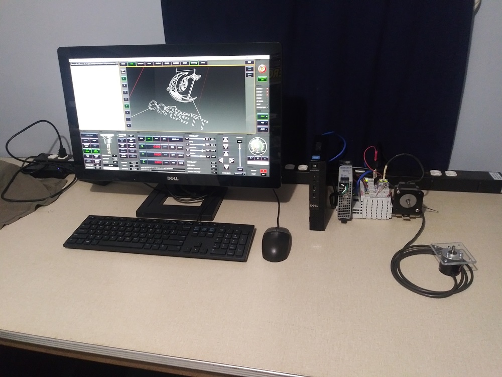

20 May 2023 06:03 #271709 by CORBETT
@ 0x2102
How did Kernel 6.3 work.  I had seen on John Thornton's site that latency was problematic after 5.10 with using Ethernet on Mesa cards, so I wasn't sure if that would affect EtherCAT as well.
@ Rod Webster
I remember those days. At college our mainframe gave each terminal 11k and we programmed in basic. Sometimes we'd enter the data using mark sense cards and a pencil.. Then they bought a couple of Apple II pcs with 48k of Ram and 170 k floppy....... I remember paying $1k for a 40 Mb HDD.
Ouch, so you felt the pain also  , yeah I am glad things have gotten affordable.  Speaking of HDD's, I can't remember what year it was, but we picked up a 4Gb drive and I remember telling my Dad: "We will never fill it up" LOL LOL LOL, well I was completely wrong...  Yeah, Texas Instruments sent Basic with the computer, I never did get deep into it as I was just trying to get around Unix alone, but I do remember doing a few of the simple little programs in basic on a commodore computer back in the mid 80's right before we got the TI server.
Yeah I still haven't checked out the DEB's as I am still overloaded with work and don't have time to tinker... I'm really under the gun now.
But, since I last posted and over last weekend, I have built 8 complete systems using Bullseye, with LCNC 2.9 RIP, IgH EtherCAT build, Sasha's Driver, Touchscreen with Dragon_HD GUI all working without issues, fires right up everytime.  I have gotten the builds down pat to the point that not having to do any work arounds for anything other than the realtime.mk fix.  Didn't do the Mutex fix, but don't think that is needed anymore since RTAI was dropped by Sasha. I am going to look at the realtime.mk fix a little bit more when I have time.  Just copied what Stormholt had.  Even have the libethercat.so linked correctly so that it works out of the box without editing the /.profile.  I'm setting them up like I have the current 2.8 deployment at each machine so that when you turn on the disconnect to the machine it will automatically fire up LCNC with Dragon.  That way no one has to do anything but start work.  I still have more HAL to write but wanted to make sure E-cat worked with Dragon, and simply did a couple of pins to make sure.  The only thing I have left is figuring out how to have a NGC file load automatically like you would in Axis.  I tried the same way as Axis under the [DISPLAY] section and adding OPEN_FILE = /full/path/to/filename.ngc but it didn't work like Axis does. Plus Jim and/or Chris Morley may not have it set up to work. When I have time, I'm going to post on the qtvcp section to find out.  I simply want the current production job to load so that a basic machine operator can go right to work without screwing around wasting time.  Right at the moment that machine operator is me LOL LOL LOL.
I just made a quick setup in HAL using a EL7041 and stepper as a spindle motor.  I am checking out [SPINDLE] code as it was implemented in 2.9, plus a few other things I wanted to look at.  I was pretty content as was using AXIS with Devils Pie, so it made a nice full screen... but after
seeing Jim's Dragon_HD GUI, I was impressed and decided to step up to Bullseye & 2.9... plus I need to keep somewhat updated. (I still
had one of them running wheezy with 2.7).
