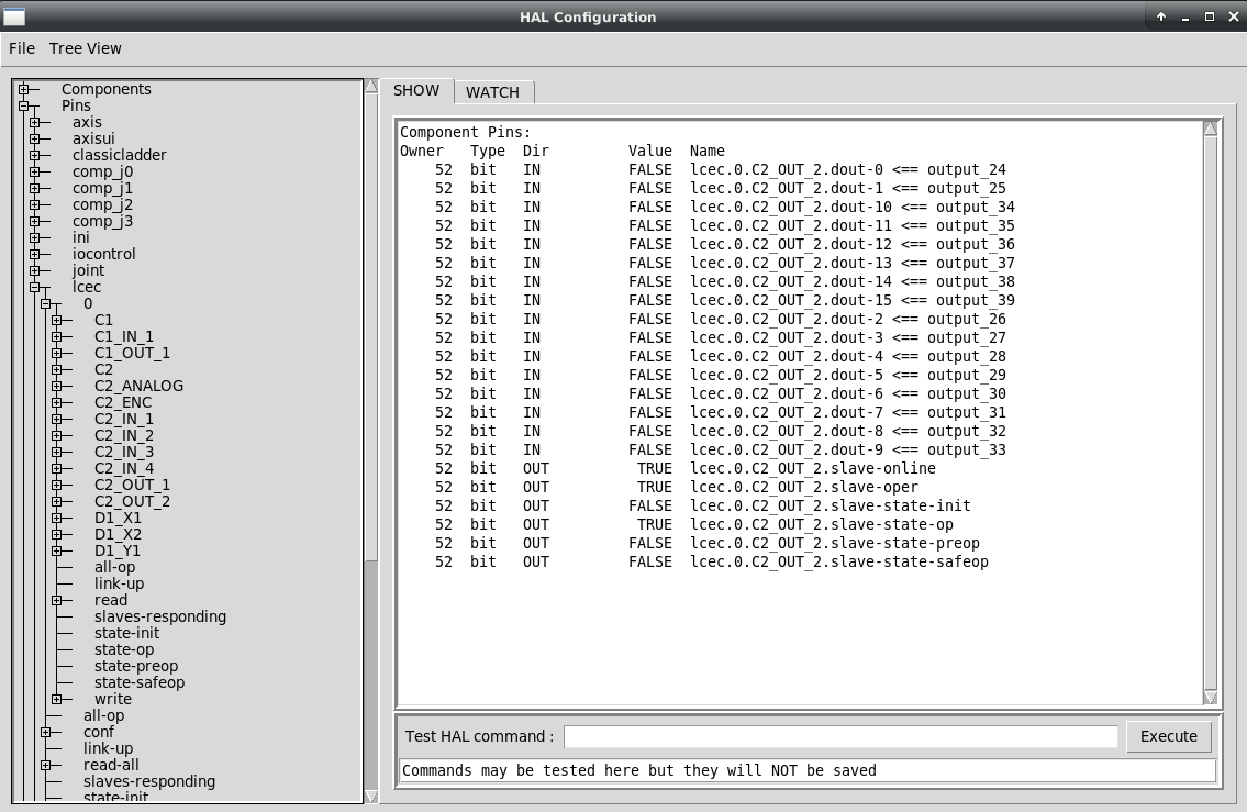

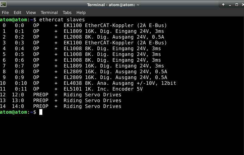

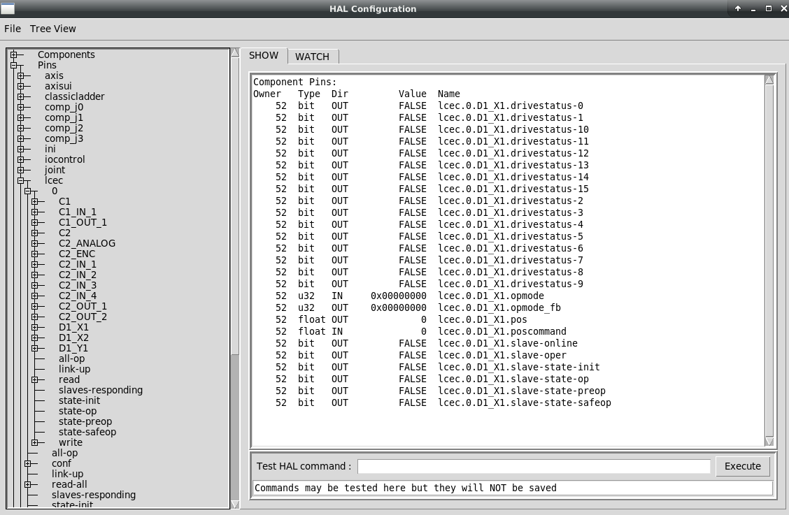

Hi,I am trying to setup a GHA servo drivers but i dont know how , the drivers and motors work in twincat but when i go to linuxcnc i cant pass the preop mode , the ethercat loop is ok , they are declared in the xml file with generic setup but in the HAL configuration everything is offline and i dont know why , anyone have a similar setup ??? or can shine some light on me pls.Any help is greatly appreciated. I'm really new to this all!

hi,
what tells dmesg about the ethercat errors?

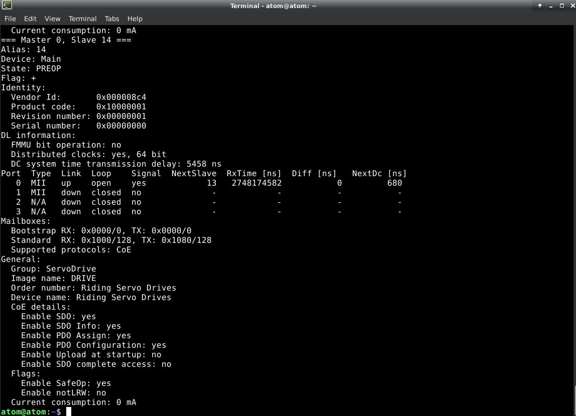

Update on my situation , the problem was the VID and PID values , i did run the commands that you mentioned and what stood out was :
[ 111.768677] EtherCAT DEBUG 0: ecrt_master_slave_config(master = 0x0000000046fd6cd5, alias = 0, position = 0, vendor_id = 0x00000a88, product_code = 0x0a880004)
[ 111.768678] EtherCAT DEBUG 0: Creating slave configuration for 0:0, 0x00000A88/0x0A880004.
[ 111.768679] EtherCAT DEBUG 0 0:0: Slave 0 has no matching vendor ID (0x000008C4) for configuration (0x00000A88).
after i used the ethercat cstruct command to see this :
/* Master 0, Slave 0, "Riding Servo Drives"
* Vendor ID: 0x000008c4
* Product code: 0x10000001
* Revision number: 0x00000001
and changed from :
<slave idx="2" type="generic" vid="00000a88" pid="0a880004" configPdos="true" name="2">
to:
<slave idx="0" type="generic" vid="000008c4" pid="10000001" configPdos="true" name="0">
