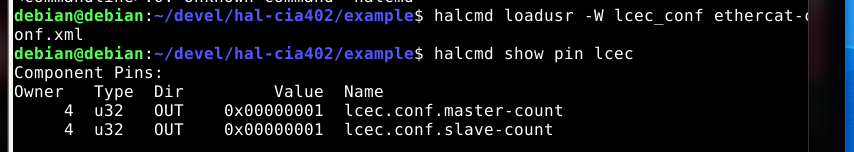

Rod, I forgot to mention in the last post, that halcmd show pin lcec works. It's loading the loadrt lcec where things don't.
