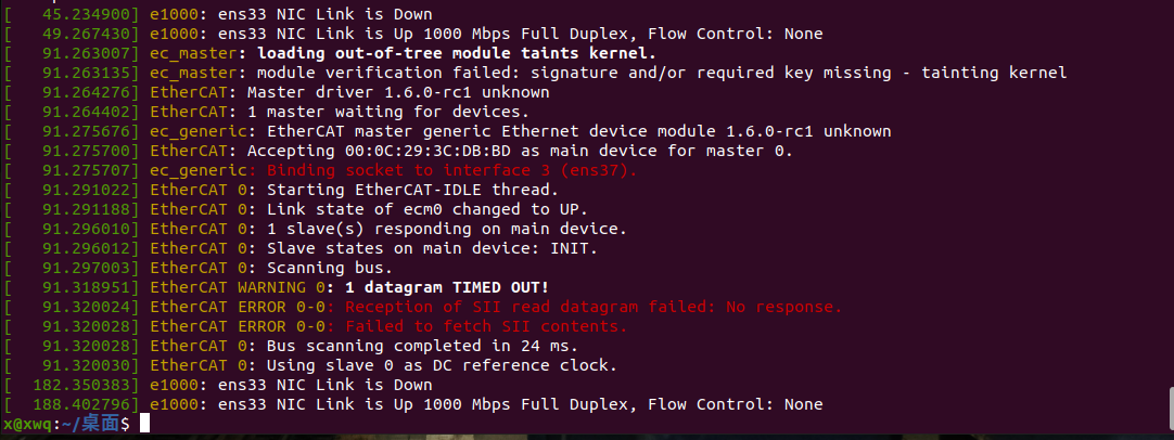

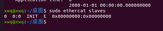

I'm a novice, and I don't understand a lot ,so I come to ask for your help. Thank you very much.The igh I installed is EtherCAT master 1.5.2 and uses a generic driver. I encountered the problem of slave identification error in slave identification. This is a headache for me, so I come to seek your advice.The kernel used is 5.10.76-xenomai.
xml:
$ ethercat slaves -v
=== Master 0, Slave 0 ===
Device: Main
State: INIT
Flag: E
Identity:
Vendor Id: 0x00000000
Product code: 0x00000000
Revision number: 0x00000000
Serial number: 0x00000000
DL information:
FMMU bit operation: no
Distributed clocks: yes, 64 bit
DC system time transmission delay: 0 ns
Port Type Link Loop Signal NextSlave RxTime [ns] Diff [ns] NextDc [ns]
0 MII up open yes - 2539282506 0 0
1 MII down closed no - - - -
2 N/C down closed no - - - -
3 N/A down closed no - - - -
xml:
Device: Main
State: INIT
Flag: E
Identity:
DL information:

looks like ethernet / driver problems.
-check dmesg for errors
-check "ethercat master" for lost frames
or
slave is buggy.

share your xml file. You did update it with your vid and pid from ethercat slaves -v?
