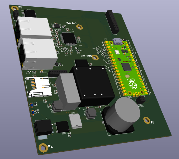

The pictures are a bit confusing. There are two ethernet ports - they are stacked vertically.

Sorry for the confusion... No pictures from the front.. It would be ilogical to make a one port slave. But its basically the same..

I wanted to make a generic ethercat slave pcb back in -21 but got frustrated because of the component shortage and didn't have the time to finish it. My idea was to create a "base board" with LAN9252 and RPi2040 (pico) that you could attach different boards to it.
If someone wants to continue this, I can share the kicad files, its pretty much done but could be made a tad simpler by removing some extra power components etc. I think this is much more hobbyist friendly as caps etc are 0603 size, uses a cheap pico etc.

Yes the AX58400 is way better. For starters you can use DMA with SPI ...
That is a very nice design, why don't you continue now that the shortage is slowly ending?
I think my problem lies somwhere in the syncManager configuration. MY board is throwing watchdog timeouts. Everything else works. The RUN led for the LAN chip stops blinking and goes solid when the link is up
Is there ANY documentation on XML options and how to?
