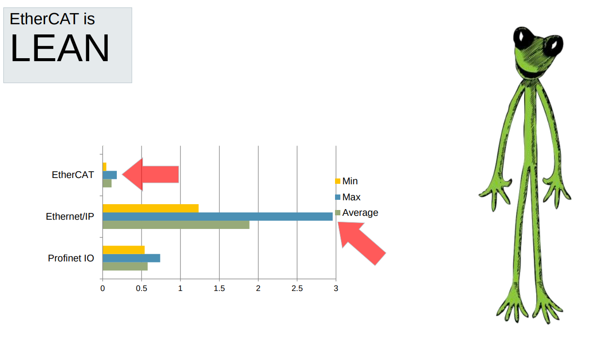

27 May 2023 19:35 #272284
Replied by rodw on topic Custom EtherCAT device
There is something very wrong with the implementation if this is truly the results you experienced. I went to an Ethercat seminar recently and it can handle 1000 I/0's in 30 usec
Tady post=272254 userid=23955I'm in early stages of coding this but I did some measurements of the time it takes and I couldn't get it under 1ms.. More like 1.7ms cycle time.. I did try overclocking the SPI from 18MHz to 36MHz and there wasn't any improvement... I will try a different IC just fir the heck of it. The LAN IC dies support up to 50MHz. I'm curently using pooling mode for testing, but I did see different projects that tried using DMA but were unsuccessful ..
