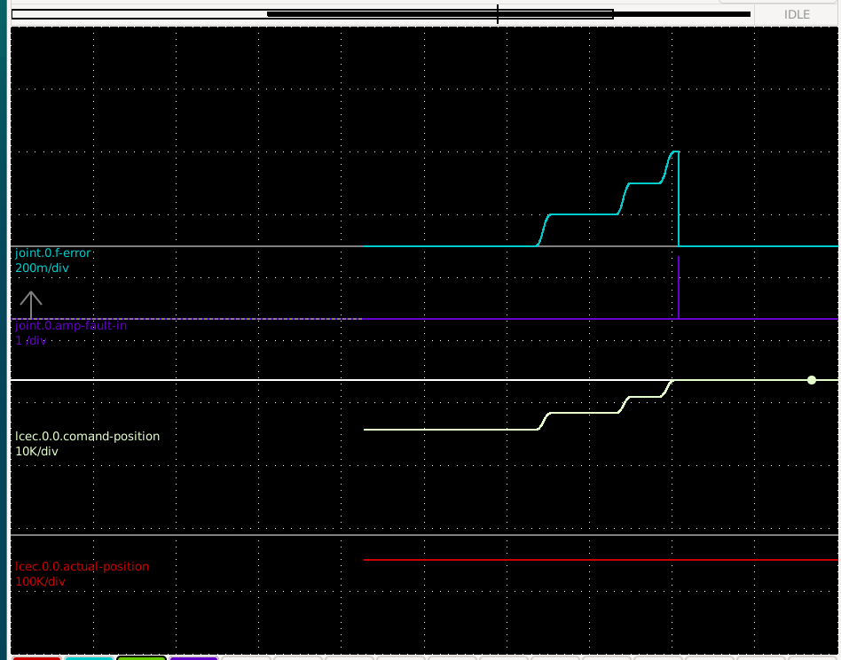

I'm trying to make first movement of an axis.
Driver is in operational mode. I toggle machine power on (F2), drivers switches from `ready` to `running` and motor starts to make some high pitch noise, not loud just audible and after i try to move joint it fails with an error "joint 0 following error X". It's actually not even need to be driven it just fails by it self in few seconds.
I think it is bad configuration but i don't know what exactly could lead to such behaviour. I have tried to change PID and ferrors but it didn't helped.
Driver doesn't show any errors.
Driver user manual is not really helpful since some of the values doesn't match with reality so i cannot verify is the data in driver set correctly or it is just showing wrong memory block.
Something like
in manual it says that 2006 subIdx 07 is "Positioning completion threshold unit setting" in fact this is not true and according to SlaveSDO it will be
2003 subIdx 14. Same story if i try to look into data from driver physical display.
I have tried to run it without PID config and with it same result.
I have used rodw-au config files as template for my config

driver is RSE400E from Rtelligent EtherCAT servo, they have promised new updated user manual for v4.0, but i don't know when they finish with it.
From which parameters i should start that it would start to spin and not trip into the error in 1 sec.
Thank you in advance.

And this is what i get in scope
- Posts: 21890
- Thank you received: 7463
07 Dec 2023 14:27 #287447
Replied by tommylight on topic Servo drive config and first movement
Seems like there is no feedback to LinuxCNC at all.
