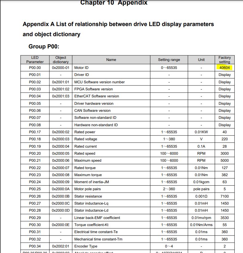

After yesterday parameter changes, and power off. it showed new error 103, abnormal value state. and was pointing to P00.00 so i have changed it back to 50000. So it should be 50000?!
- Solvarg
- Posts: 18
13 Dec 2023 08:45 #288006
by Solvarg
Replied by Solvarg on topic Servo drive config and first movement
Suppose to be the Motor ID. My manual says 40604 but if it's right, hard to say without the correct manual.
BTW, what is your motor type#?

yep i have same manual. do you also have Rtelligent driver with motor, or you have just downloaded manual in attempt to help?
motor is RSMA-M06J1330A,
other update after setting motor id back to 50000, it showed error 490, which is updates that requires power off procedure, i have done this and it showed again, so i have removed all settings for 2000 group, and now it doesn't show this error.
