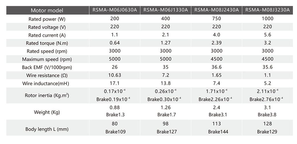

This is what i actually do, because i cannot get any value from those addresses, either they 0 or i do it in a wrong way.
if to believe manual it will be
0x2002 | Motor rated power (unit: 0.01KW) | ? P00.17 | 000.00
0x2003 | Motor rated voltage (unit: V) | ? P00.18 | 0
0x2004 | Motor rated current (unit: 0.1A) | ? P00.19 | 0000.0
This driver is 400W i have also 750W variants, i'm already thinking to check them out are they configured same or they will be different.
Edit: well i have tried different one 750w and all look same, so they are not configured from factory at all, and there is no default values inside driver. but again i cannot blindly put values to driver because amount of properties in manual and driver are different, so i'm not sure they are match.

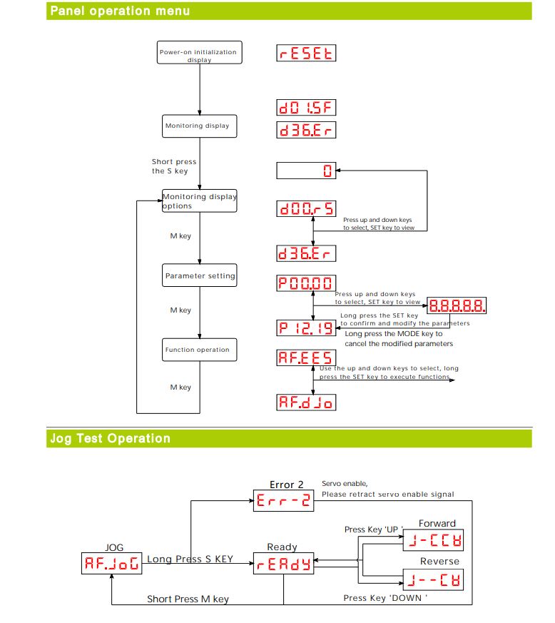

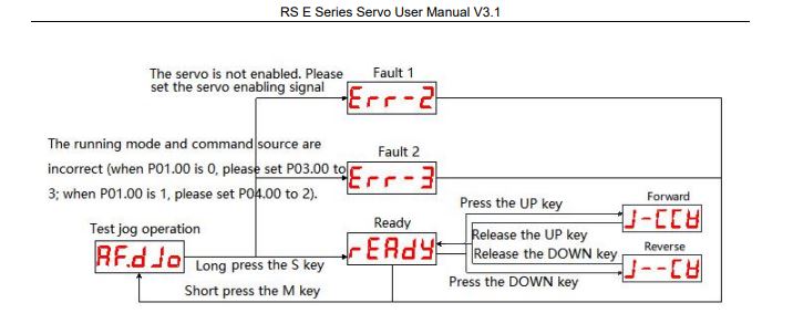

I looked at the instructions on how to manipulate drive setting via the buttons on the front, must say I have read much better instructions...
I can't say that I fully understand the procedure but if I had the drive and could play with it for a while it's probably solvable.
Have you figured out how to operate the buttons?

to Solvarg, so i have tried to change those parameters like this
and the only one thing have changed on driver LED is motor id was 50000 now is 40604 as i set it. all others are not changed on display, i going thru all available positions from P00.01 to P00.58 i haven't found my values.
to rodw. it is in first message in spoiler section, now this xml look like this
yes, 0x2003:01 is set to 03
