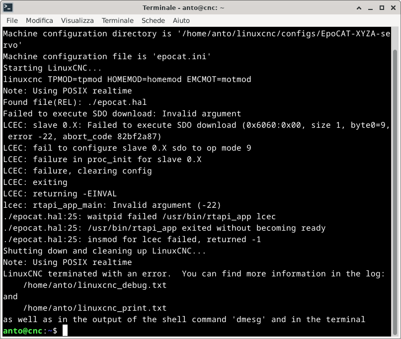

The main error message here is the only difference between 1.13.1 and 1.13.0 -- it now actually reports SDO setting failures back instead of silently ignoring them. You can try rolling back to 1.13.0 and see if that fixes things.
It'd be helpful to have more data. This looks like a generic CiA 402 device? Which hardware are you using, and can you share a copy of your XML file? Also, what was logged in `dmesg` when this happened?

the device is a Delta ASDA A2-E
I attach the xml file
by giving power to the CNC everything works, if I can I'll try to go back to 1.13.0

Well I'm a total EtherCAT newbie, but isn't this just the lcec code trying to download settings to your Delta drive? If your CNC is powered off is the Delta drive is powered off too and so if (of course) can't accept LinuxCNC commands over EtherCAT.

Entertainingly, prior to 1.13.1, it would queue SDOs for the drive asynchronously, so if they failed then nothing actually noticed. This meant that when bad settings were sent *no one could tell* until the drive failed to work. There'd be a record in 'dmesg', but very few people notice unless there are problems.
But, the flip side of this is that the way SDO settings were queued up they'd be re-set when the device powered on. So, weirdly, talking to a powered-off drive should actually have worked. That wasn't a case that I'd really considered.
We now have better error reporting, *and* we still keep SDO settings around so we can re-set them if the slave reboots. The downside is that we require that devices are powered on up front.
Is supporting powered-down devices something that we should be paying attention to?

If the devices are off, the EC master cannot connect and accordingly linuxcnc can't start. That to me is entirely logical behaviour and fine. If a mesa card is offline, linuxcnc will crash as well.

during the changes of recent weeks there was a moment in which LCNC started when the devices were turned off,
now no longer.
I thought there was a problem, but everything is ok
