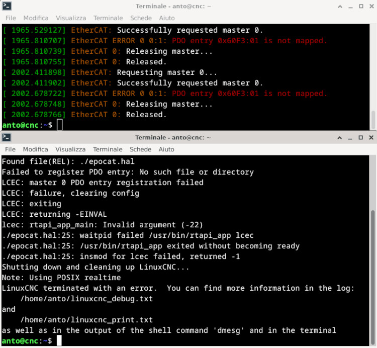

Hi ScottI don't know if this is the right place.I wanted to report a problem.I'm using the EasyIO, with the great work of recent times it is among the devices included in the EtherCAT drivers for LinuxCNC, up until now I had only used the digital IOs which are oknow with a retrofit I need to use the analog output for the spindle, I did some tests but I wasn't able to make it work, LinuxCNC in the HalShow displays that it works but nothing comes out on the outputs with the tester. out of curiosity I also tried the analog inputs and they don't show any signs of life. To verify, I tried the old .XML and the analog outputs and inputs work, while the digital IOs I hypothesize conflict with the LinuxCNC internal drivers, because they work in a bizarre way.
I attach the XML
Thanks again for your precoius work
