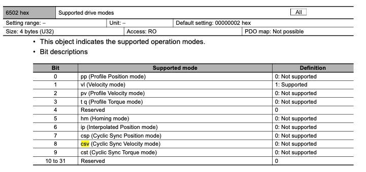

11 Jan 2024 10:50 #290437
by eduard
Replied by eduard on topic Spindle config EtherCAT
- eduard
- Posts: 80
- Thank you received: 12
11 Jan 2024 12:14 #290440
by eduard
any idea how can I solve this:
to enable the spindle rotation I have to send dec 15 to spindle-controlword, but net spindle-enable receives just bit.
or maybe the good question is, how can I send to spindle-controlword the dec15?
I think the cia402 is not working on VDF since not have just VL (velocity) mode.
