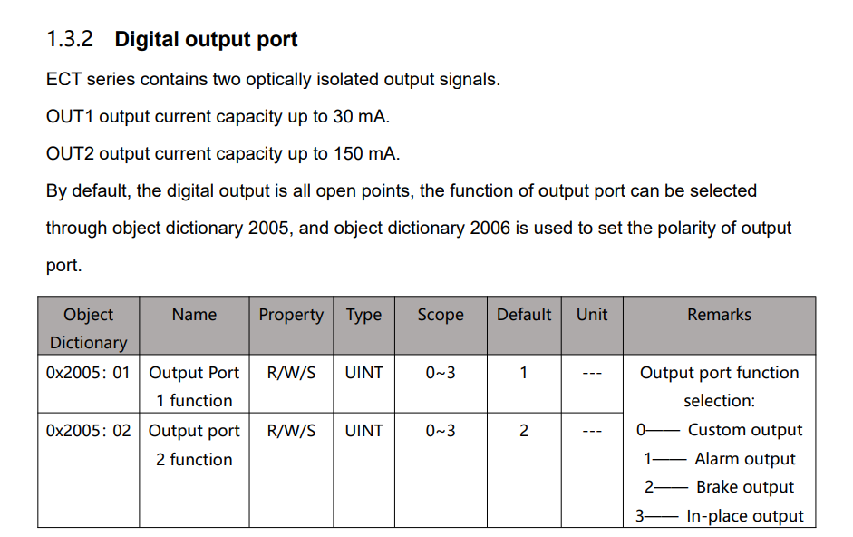

on the ECT60, The digital inputs are at 60FD per your documentation. Here is how I defined them
github.com/rodw-au/linuxcnc-cia402/blob/main/ethercat-conf.xml
But Rtelligent does not have any listing in their manual for outputs in the CIA402 workspace. Instead they are in the manufacturer's space at
204A
I assumed that outputs were not part of the CIA402 standard.
I'm sure it won't be hard to get inputs and putputs into your driver. Hope this helps

Yeah, outputs are listed in the standard as being at 60fe, and `ethercat sdos` shows that the ECT60 has them there, but weirdly it doesn't appear in the manual. I'll figure out what's up soon enough.

Thanks. I have those already, as <modParam name="output1Func" value="brake"/> and so forth. There are a lot of modparams here
I had output1 working, but output2 wasn't, and none of the inputs worked, even with "ethercat upload" for reading the PDO values directly. I probably just mis-read the wiring colors or something. I'll get back to it in a day or two.

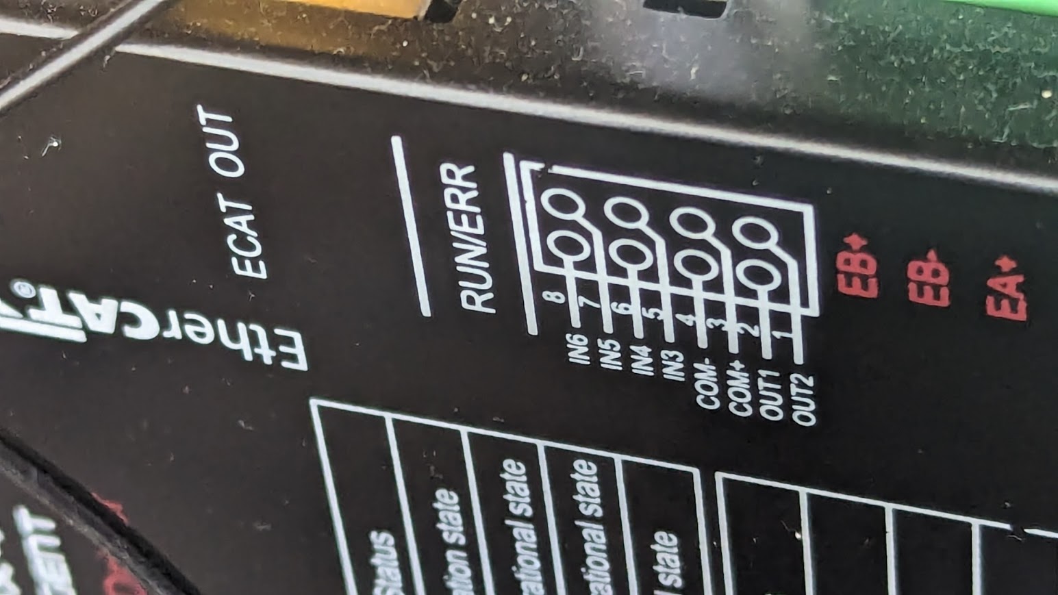

Minor update: I think there's actually a hardware issue here with my ECT60's I/O ports. At a minimum, I can't find the "COM+" wire, which I assume is supposed to have +24V. My multimeter measures 0V to ground on all 8 pins of the I/O connector. I should have a replacement in hand :before too long, as well as a few other CiA 402 devices for testing.
