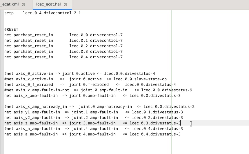

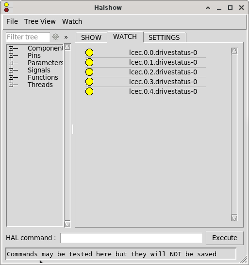

Hello Everyone,
I was trying different suggestions as per post replies but not getting foolproof system. However I was monitoring Hal configuration. I found one pin "lcec.0.0.drivestatus-0" which is representing drive OP state. This pin goes high when drive is healthy and is in OP state.
I have already configured Axis Fault alarm to "lcec.0.0.drivestatus.3" because it is going low when drive is healthy and there is no alarm.
Now, do I need to invert "lcec.0.0.drivestatus-0" ? How it can be done? And if there is other option to link this pin with Emergency or even axis limit(ghetto idea) or anything which prevents EMC power-on(Servo-On)
Or may be more reliable setup
Check drive status
If ok then only power On, or else alarm
Check Servo On
If ok then only power on or else alarm
Thanks in Advance.

11 Jul 2024 01:26 #304864
linuxcnc.org/docs/devel/html/man/man9/not.9.html
Replied by Aciera on topic How to monitor OP mode in Panasonic A6B Ethercat
Maybe try the 'NOT' component:Now, do I need to invert "lcec.0.0.drivestatus-0" ? How it can be done?

11 Jul 2024 01:49 #304865
by onceloved
Replied by onceloved on topic How to monitor OP mode in Panasonic A6B Ethercat
It is recommended to solve the problem from the root. One of the three servo drives I had before, the z-axis, also randomly failed to operate. Later, I found that the xml version in this drive was different from the other two. It was higher than the xml version in the other two drives, and it would automatically create a network interface. Later, I copied the sii data in the x-axis servo drive and wrote it to the z-axis servo drive that randomly failed to operate.
The following user(s) said Thank You: marq_torque
- onceloved
- Posts: 134
- Thank you received: 59
11 Jul 2024 01:53 #304866
by onceloved
You can run it multiple times to find the servo drive that can OP every time. Use ethercat sii_read to read the sii data in it and compare it with the sii data in the drive that cannot OP to find the difference. The easiest way is to use ethercat sii_write to write the good sii data. It has been several months since I solved this problem and this problem has never appeared again.
