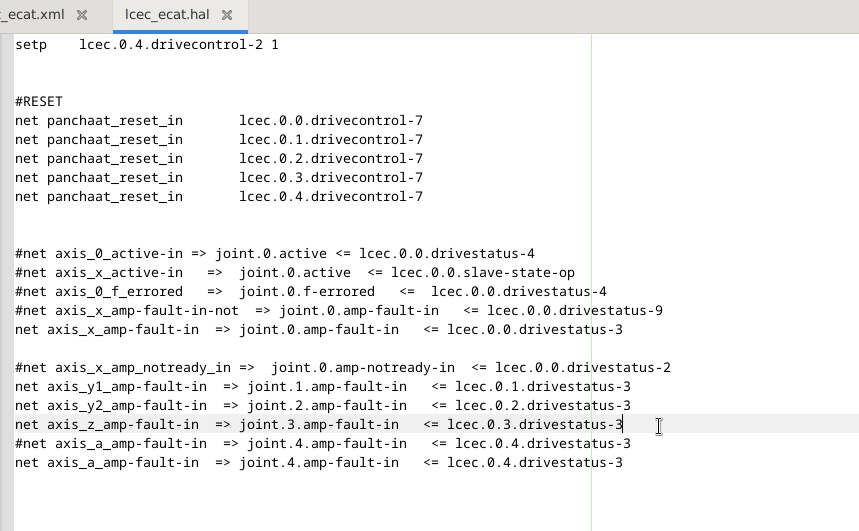

11 Jul 2024 09:04 - 11 Jul 2024 09:10 #304880 by marq_torque
Replied by marq_torque on topic How to monitor OP mode in Panasonic A6B Ethercat
Now, do I need to invert "lcec.0.0.drivestatus-0" ? How it can be done?
Maybe try the 'NOT' component:
linuxcnc.org/docs/devel/html/man/man9/not.9.html
I think I already tried using "not" component, can you confirm this is right format?
Last edit: 11 Jul 2024 09:10 by marq_torque.

11 Jul 2024 09:23 #304884 by Aciera
I know nothing about EtherCAT, so I have no idea if you can get an inverted value back from the drive. What I suggested was using the built in HAL component called 'NOT'. For which you would need to use 'loadrt' and 'addf' commands and connect the input and output pins in hal.

11 Jul 2024 18:18 #304937 by Aciera
in your hal file:
To load the realtime component (the name 'not.myexample' is arbitrary)
loadrt not names=not.myexample
For the component to be executed in the servo-thread we need to add it.
Note: The order of how components are added to the thread matter. You will want this after the ethercat read and before the ethercat write. Otherwise you may loose a cycle before the state is valid.
addf not.myexample servo-thread
Then you can connect the signals:
net some_signal_name <= hal_pin_to_be_inverted => not.myexample.in
net some_other_signal_name <= not.myexample.out => some_hal_pin
