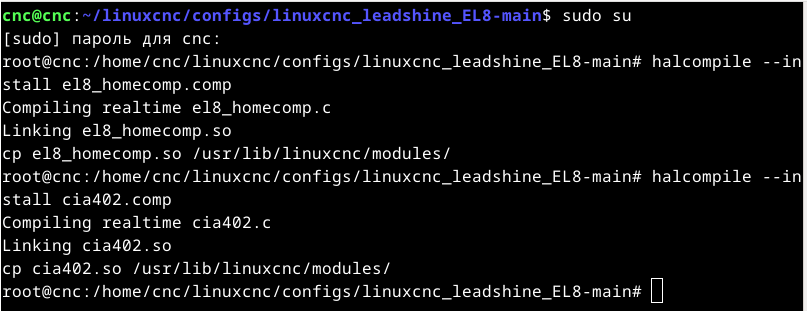

from the first repo, edit the el8_homecomp file, and change the path to homing.c file, to where you saved your files.
compile the cia402.comp:
sudo homecomp --install cia402.comp
compile the el8_homecomp.comp:
sudo homecomp --install el8_homecomp.comp

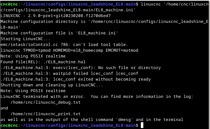

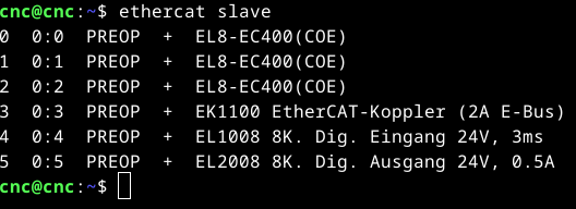

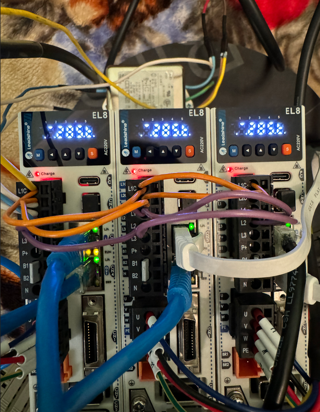

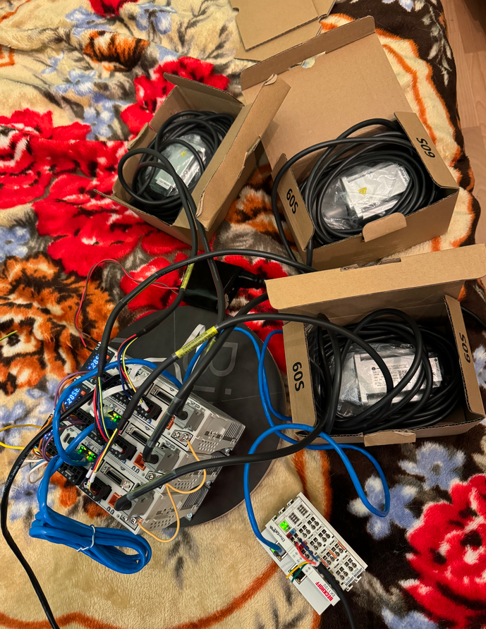

Hi guys!I want to repeat the project Marco Reps, I bought these servo amplifiers but I have problems with starting. I have assembled a test configuration on the table and am trying to run it linuxcnc. I've made some progress, but I really need your help!I can rotate the motors if I connect to the USB in the leadshine Motion studioTell me, do I need to change any servo settings for the first launch?I get a response when I request ethercat slaveI have attached screenshots of my startup problem, all the Marco Reps files I am experimenting with and photos of the servo amplifiers (look at what they show on their displays? is this correct?)I really need your help in getting this system up and running.

It appears you have issues with the lcec_conf module?
Attached xml file has 4 drives defined and you only have 3 in the picture?
From your pictures of the drives I would also recommend you go and look at the correct installation/wiring recommendations in the manual before you damage one of the drives. (Space around the drive, and not daisy chaining the wiring like you have). I get it is a test setup... so might be changed in the future.

Oh my friend, I know how to install servo amplifiers, this is just a test configuration that lies on the bed. Then I will assemble everything as it should be according to all the rules.
I changed the ethercat-conf.xml file, it didn't work

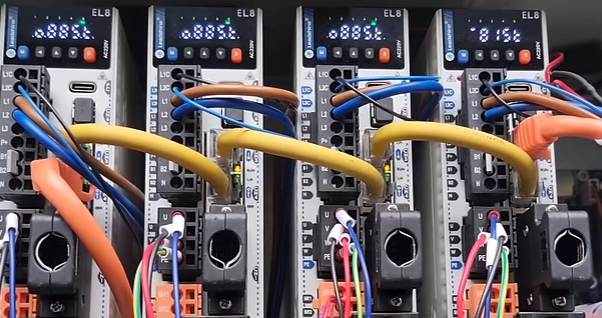

I don't understand why after turning on my servo amplifiers they have a different indication than Marco Reps
Indication of my amplifiers
they are all determined

Indicators are different because the picture from Marco they are in the operational state.
When I configured my xml file I used the halrun to load lcec_conf from the command line without the GUI to check it was all okay.
Can you do "ethercat -v slaves" to grab the model numbers etc just to check they match your XML. After that you will need to catch a more specific error out of the lcec_conf output to narrow down what is wrong.
