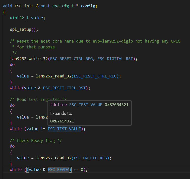

14 Dec 2025 10:54 #340091
by Hakan
Replied by Hakan on topic Ethercat compatible Encoder board tentative STM32F4 + LAN9252
PDI = that parallel communication mode? Noone uses it. Everyone uses SPI.
The last few lines in the xml file should look similar to this. The first "80" means spi, then there
is polarity and other settings.Read out the eeprom from the board and verify that is says "80" in the first byte.
I have had my fair share of problems with SPI so I think you again should verify that you can get past the ESC_init() function.
Use the debugger and verify that you read 0x87654321 from LAN9252 on line 445 in the figure
You may need to power cycle the LAN9252, it only reads eeprom after power down.
<Eeprom>
<ByteSize>2048</ByteSize>
<ConfigData>80060344640000</ConfigData>
</Eeprom>I have had my fair share of problems with SPI so I think you again should verify that you can get past the ESC_init() function.

14 Dec 2025 21:07 #340099
by vibram
Replied by vibram on topic Ethercat compatible Encoder board tentative STM32F4 + LAN9252
My ESC TEST VALUE reading is fine...
i tried a lot of things but dont know why i cant get the eeprom correctly set up. Maybe its something with the board I dont know

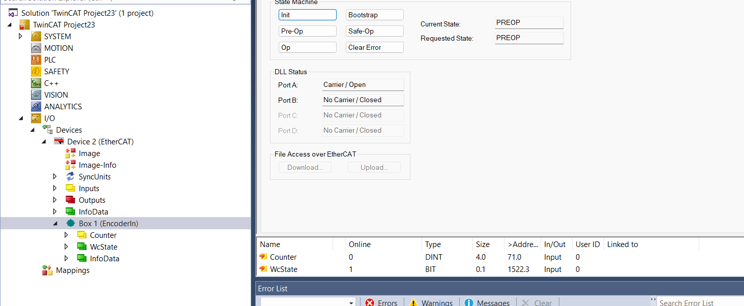

16 Dec 2025 12:24 #340188
by Hakan
I connected up the hardware in the same way as your system. It didn't want to go to PREOP.
It seems you have been editing a lot, at least some, in lib/soes and I would say that's a big no-no. Leave that as is.
I restored lib/soes from E7000, fixed settings for SPI, removed all SPI from main.cpp, modified loop() and the card is now up and running in PREOP.
You shouldn't need to make a lot of editing in lib/soes, only to get SPI running and I think it was fine the way you did it.
All editing for SDOs PDOs etc are done through the EEPROM_generator, no manual editing is needed.
- vibram
- Posts: 84
16 Dec 2025 13:12 #340189
