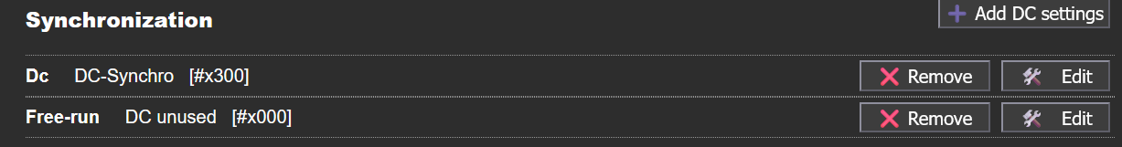

Let's start with free-run
Add this to eeprom-generator
The 000 is the one I have in mind, but have both of them in there.
Save all, burn eeprom, compile and upload firmware in the usual way.
In ethercat-conf.xml leave out the <dcConf ... > statement for the slave. That makes it use free-run mode.
It should now work in free run mode.

It's already working in free run mode, I can see my encoder value in twincat such as in your 3rd video
You mean the linuxcnc file?ethercat-conf.xml
