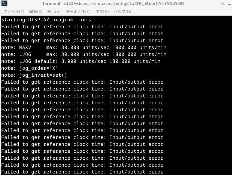

27 Dec 2025 02:44 - 27 Dec 2025 02:56 #340564 by tar_san
Thank you so much.
Result:
A12 Servo driver alarm has vanished.
I could "ServoOn", "Jog move". without any error in Servo Driver LED.
Buf I got this  message "Failed to get reference clock time: Input / Output error"  many times. (screenshot)

But I'm not familier about EtherCAT master, I'm not sure what to do next, so please guide me, everyone
And I'd like to summerize procedures what I have done with your great help to get Yaskawa worked with LinuxCNC for those who are not so familier with EtherCAT master in detail like me.
