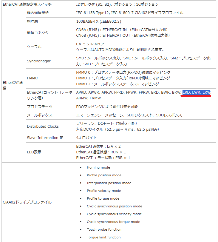

- tar_san
- Posts: 40
30 Dec 2025 12:55 - 30 Dec 2025 13:14 #340710
by tar_san
Replied by tar_san on topic refClockSyncCycles="-1", I got Messages.
Thanks everyone.
Now I can make Yaskawa Sigma X OP state and jog move from LinuxCNC stably. ( Just did EoE disabled. )
Slave : SGDXS-xxxxA0x EtherCAT(CoE) SERVOPACK Rev02.09
According to the specification on Web, ( www.e-mechatronics.com/product/servo/sgm...c/xs_ether/spec.html)
LRD, LWR and LRW seem to be supported. (attached image)
But Sorry, I'm not familier with this problem.
Which configuration seems to be better in this situation?
refClockSyncCycles="-1" , with messages "Failed to get reference clock time: Input/output error"
refClockSyncCycles="1" no messages
Should I check some error from log?
Last edit: 30 Dec 2025 13:14 by tar_san.

30 Dec 2025 14:06 - 30 Dec 2025 14:07 #340712
by Hakan
Replied by Hakan on topic refClockSyncCycles="-1", I got Messages.
Ok, well that went over my head. Was so focused on the LWR issue.
You need to get rid of most of the "UNMATCHED" messages in the syslog.
"UNMATCHED " are usually caused by bad latency or very commonly by using RealTek network adapters.
If you have a Realtek network adapter, you should install the r8152-dkms or r8168-dkms driver via apt.
Can you show the output of "lspci -k"? Only the network interfaces are of interest.
