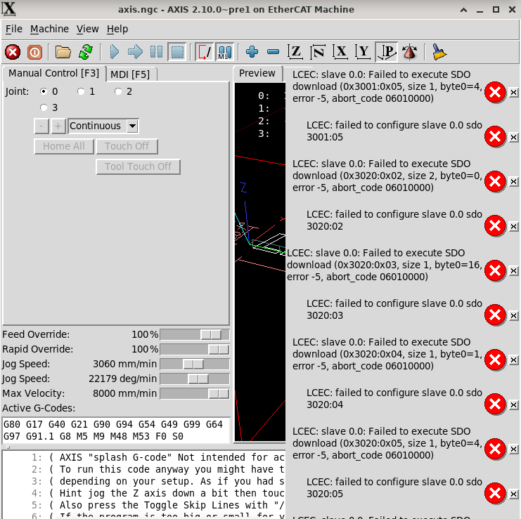

I'm trying to set the catio-a I/O module to talk to a VFD via Modbus but I am at a bit of a loss.
Excerpt from Ethercat sdos
I got this for the xml file but I get errors reported but eventually axis opens without any syntax issues with
Failed to Execute SDO download size 1, byte0=0 error -5, abort code 06010000
subIdx 0 = read only
subIdx 1 is a PDO so no need to set in SDOs, PDO definition works
SubIdx 7 is a error count
If you have ideas, please have a go.
Would the VFD need to be connected via rs485? I have not done that yet.
SDO 0x3000, "Set Modbus reg W"
0x3000:00, r-r-r-, uint8, 8 bit, "SubIndex 000"
0x3000:01, rwrwrw, uint16, 16 bit, "SubIndex 001"
0x3000:02, rwrwrw, uint16, 16 bit, ""
0x3000:03, rwrwrw, uint8, 8 bit, ""
0x3000:04, rwrwrw, uint8, 8 bit, ""
0x3000:05, rwrwrw, uint8, 8 bit, ""
0x3000:06, rwrwrw, uint8, 8 bit, ""
0x3000:07, rwrwrw, uint16, 16 bit, "�"I got this for the xml file but I get errors reported but eventually axis opens without any syntax issues with
<sdoConfig idx="3000" subIdx="2"><sdoDataRaw data="00 10"/></sdoConfig> <!-- Address 0x1000 (Swapped) -->
<sdoConfig idx="3000" subIdx="3"><sdoDataRaw data="10"/></sdoConfig> <!-- Length: 16 (Hex 10) -->
<sdoConfig idx="3000" subIdx="4"><sdoDataRaw data="01"/></sdoConfig> <!-- Slave ID: 1 -->
<sdoConfig idx="3000" subIdx="5"><sdoDataRaw data="04"/></sdoConfig> <!-- Type: 4 (Holding Register) -->
<sdoConfig idx="3000" subIdx="6"><sdoDataRaw data="01"/></sdoConfig> <!-- Enable: 1 -->subIdx 0 = read only

Does it work when you set the values with ethercat download/ethercat upload?
- Posts: 12156
- Thank you received: 4149
02 Apr 2026 03:06 #345043
Apparently not. Looks like I have to lug a spindle into my office. Is the syntax right?
Replied by rodw on topic Ethercat SDOS to XML
cnc@linuxcnc:~/linuxcnc/configs/catioa$ ethercat slaves
0 0:0 PREOP + IMC IO MODEL with EtherCAT
cnc@linuxcnc:~/linuxcnc/configs/catioa$ ethercat download -p 0 3000 2 0x1000 -t uint16
SDO transfer aborted with code 0x06020000: This object does not exist in the object directoryApparently not. Looks like I have to lug a spindle into my office. Is the syntax right?

0x3000 perhaps? Try upload to read the register.
- Posts: 12156
02 Apr 2026 03:20 #345045
yeh, I tried 0x3000 and had no more luck (it is a hex value)

Strange. If it's in the sdos listing I have always been able to read the value with
ethercat upload -p 0 0x3000 2
for example.
for example.
- Posts: 12156
02 Apr 2026 04:21 #345048
I've always set the SDOs in the xml
So I had a play when I worked out I needed to use 0x3000 and despite all of linuxcnc's complaining, the entries were set correctly.
Do SDO's persist on power cycles?

answer no they don't

I also set them in xml. But troubleshoot and experiment on the command line.

Weird. I was right all along. !!!
After powering the IO board on and off, the SDO's are set to zero.
Restarting Linuxcnc again in this state linuxcnc opens without reporting any errors.
But if you close Linuxcnc and restart it, it reports errors on all of the SDO's.
I've never seen that before.
Thanks for the help. At least I can proceed to actually test on the spindle now!
