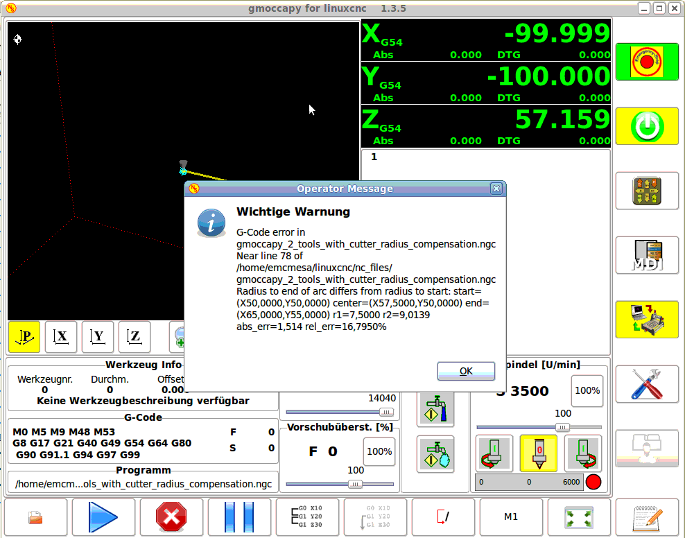

I just pushed gmoccapy 1.3.5.1
I did find a way to show possible gcode errors while loading the gcode file.
I think with this we solved one big issue!
The error will be shown in an Warning window. It is modal and will requiere the user to push OK to continue.
Would it be better to make the message as a small gmoccapy pop-up message?
It is in 2.6, 2.7 and master branch, not jet in the deb packages.
Norbert

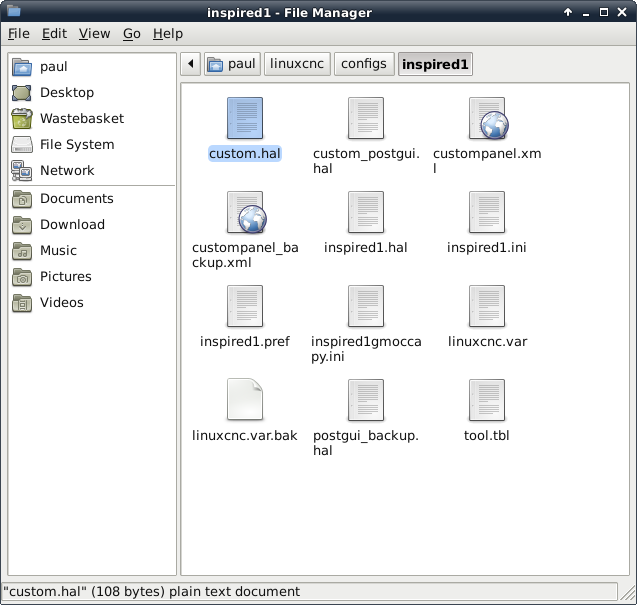

28 Dec 2014 04:42 #54323 by 2e0poz
Replied by 2e0poz on topic Gmoccapy - A new screen for linuxcnc
Ok will explain first what the issue is. I was expecting gmoccapy files to be in my config folder and none exist, in the error report that pops up after trying to run it refers to the files that are not there.
I need my head so please be gentle :)
28 Dec 2014 04:47 - 28 Dec 2014 04:50 #54324 by 2e0poz
Forgot to say the install went fine and Axis runs allowing me to run a test code run (no machine connected yet)
Last edit: 28 Dec 2014 04:50 by 2e0poz.
28 Dec 2014 06:17 #54326 by newbynobi
Replied by newbynobi on topic Gmoccapy - A new screen for linuxcnc
Just read the error and you will find:
Custom_postgui.hal:7 pin pyvcp.spindle-speed does not exist
Please clear you hal files and you are done, all other errors we will clear later.
Norbert
The following user(s) said Thank You: 2e0poz
