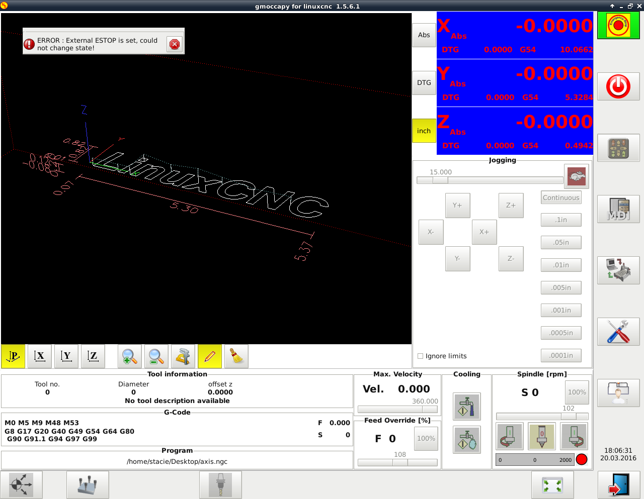

20 Mar 2016 22:57 - 20 Mar 2016 23:18 #71955 by cncnoob1979
Replied by cncnoob1979 on topic Gmoccapy - A new screen for linuxcnc
Hey!
I just started using Gmoccapy today. I switched a configuration from axis to this. However I am having a strange issue and I do not encounter this in Axis.
When I enable the machine via releasing the E-Stop software button in Gmoccapy, I get about 5 to 10 pulses to my mechanical relay to activate the machine. In other-words, when hitting the enable button in Gmoccapy I get around 10 pulses of voltage to my enable relay.
In axis I do not have this behavior. Sometimes with this happening the machine will not enable and will error out stating it can not change the e-stop state.
I'm curious as to why?
EDIT: I have checked my E-Stops and they are not the cause. They are external to the controller and I would not have power if they were tripped. Do I need to connect to a pin in Gmoccapy for the estop?
I am running LinuxCNC v2.7.7-18 from buildbot.
Here is my hal file.
Warning: Spoiler!
And here is my INI
Warning: Spoiler!
Last edit: 20 Mar 2016 23:18 by cncnoob1979.
22 Mar 2016 15:58 #72036 by newbynobi
Replied by newbynobi on topic Gmoccapy - A new screen for linuxcnc
I can not see anything strange in your config, but the behavior you discribed is unusual.
What happen if you use external button?
Norbert
