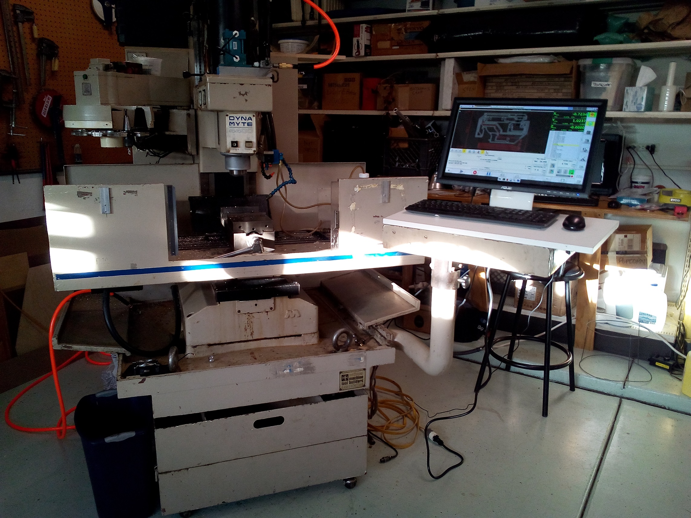

Comments and a question--I have been using LinuxCNC with Axis for several years on a router I built, I have just recently converted a DM4400 mill to LinuxCNC, added a touch screen, and started using Gmoccapy for the first time. Thank you very much for all your effort on this, I love it. I attached a picture of the machine set up in my garage.
My question is, while using Axis it automatically included a check box for my spindle brake, but that is not available in the default setup for Gmoccapy (or else I just can't see it). I am assuming I will need to add that myself, but I don't know how it's done. Can you point me in the right direction for how to do that please, I would appreciate it. I need to be able to disable the brake while doing setups on the machine.
Dan

Hallo Dan,
very nice machine and nice GUI
Of course I will help you as much as I can.
I would recommend to use a custom embedded panel for that, and place that one in
box_custom_4 (will introduce your glade file right of spindle_frame)
you can find more documentation here
Just use glade to make your panel (i.e. spindle_brake.glade) with the needed hal widgets and include it like so:
You need to do the corresponding hal connections in spindle_brake.hal
Norbert
