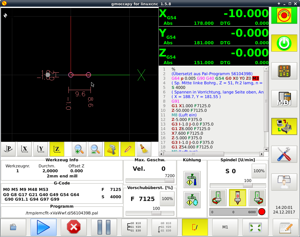

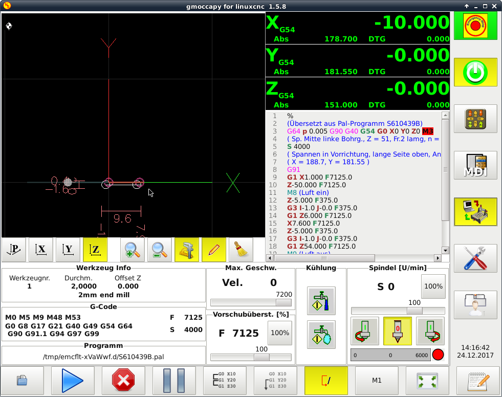

24 Dec 2017 13:36 - 24 Dec 2017 15:21 #103544 by kjacobs
Replied by kjacobs on topic Gmoccapy - A new screen for linuxcnc
Hello,
when I am using a non-integer G54 offset, the preview is offset by the non-integer part of the offset compared to the tool trace (see attached image ...offset1.png) With integer G54 coordinates, the offset is gone (..._no_offset.png). I observed this with gmoccapy 1.5.8 on lcnc 2.7.11 and with gmoccapy 2.3.3.2 on lcnc 2.8.0~pre. Am I doing something wrong or is this a known issue?
Greetings,
Karl
P.S. there is no offset when using the axis GUI
P.P.S found the solution: this happens only in the LANG=de_DE.utf8 setting and disappears in LANG=en_US.utf8, so it seems to be a mixup in the decimal delimiter evaluation. Sorry for the "spam", but it still looks a bit buggy to me.
Last edit: 24 Dec 2017 15:21 by kjacobs. Reason: P.S. addition, solution
