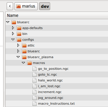

Norbert
I seem to have a problem loading any macro file. It works in the sim config but not in any of my live configs.
I tried it on my new desktop mill as well as the plasma config. The error says

- mariusl
27 Dec 2013 03:59 #42042
by mariusl
Regards
Marius
www.bluearccnc.com
Replied by mariusl on topic Gmoccapy - A new screen for linuxcnc
Hi Norbert
As you can see from the picture, the path is set correctly. The macros directory is under my config directory and the files are in there. I have created some of my own files as well. It does not see anything.
Out of desperation I started to write some subs to use with V buttons but I would rather use the macros if I could.
I have set the path up any way possible but it still does not pick up the files.

- newbynobi
- Posts: 1931
- Thank you received: 394
27 Dec 2013 04:39 - 27 Dec 2013 04:40 #42043
by newbynobi
Replied by newbynobi on topic Gmoccapy - A new screen for linuxcnc
Hallo Marius,
check:
- What is in your [MACRO] section?
- What is under [RS274NGC] ; SUBROUTINE_PATH
- What files are in that path?
- do the files fit the following needs?
The name of the file must be exactly the same as the name given in the MACRO line.
So the macro i_am_lost will call the file i_am_lost.ngc.
The macro files must follow some rules:
- the name of the file need to be the same as the name mentioned in the macro line, just with the ngc extension
- The file must contain a subroutine like so: O<i_am_lost> sub, where the name of the sub must match exactly the name of the macro (case sensitive)
- the file must end with an endsub command O<i_am_lost> endsub followed by an M2 command
- the files need to be placed in a folder specified in your INI file in the RS274NGC section (see [RS274NGC]:
I tested that just now on my test machine, and it does work fine.
Norbert

- mariusl
27 Dec 2013 04:49 #42044
by mariusl
Regards
Marius
www.bluearccnc.com
Norbert
# for details see nc_files/subroutines/maco_instructions.txt
[MACROS]
MACRO = goto_tc
MACRO = halo_world
MACRO = jog_around
MACRO = increment xinc yinc
MACRO = go_to_position X-pos Y-pos Z-pos
MACRO = set_tc
SUBROUTINE_PATH = home/marius/dev/bluearc/configs/bluearc_plasma/macros
As you can see I am using the original files to test with.
[MACROS]
MACRO = goto_tc
MACRO = halo_world
MACRO = jog_around
MACRO = set_tc
Regards
Marius
www.bluearccnc.com
- newbynobi
- Posts: 1931
27 Dec 2013 05:20 #42046
by newbynobi
Hallo Marius,
I do think the problem is you path:
Try:
SUBROUTINE_PATH = ~/dev/bluearc/configs/bluearc_plasma/macros
or even better try relative path like:
SUBROUTINE_PATH = macros
if your ini file is under: configs/bluearc_plasma/
Norbert
Try:
Norbert
