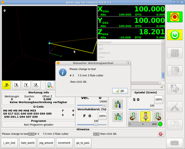

gmoccapy 0.9.9.7.4
- the default tool change dialog now shows
the tool number and the tool description
Norbert
