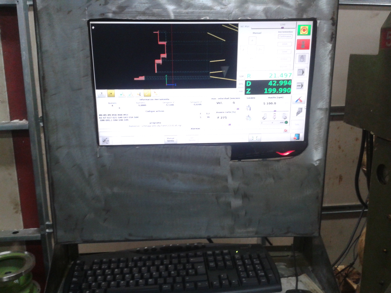

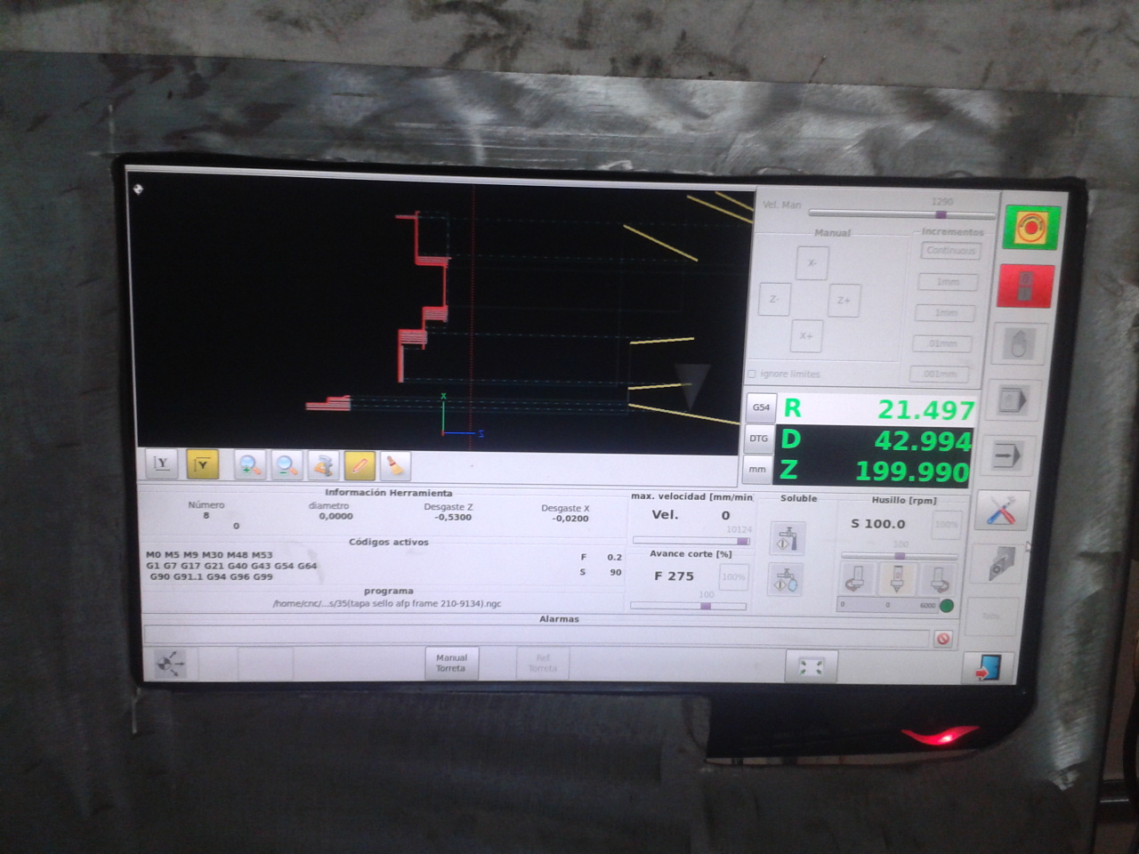

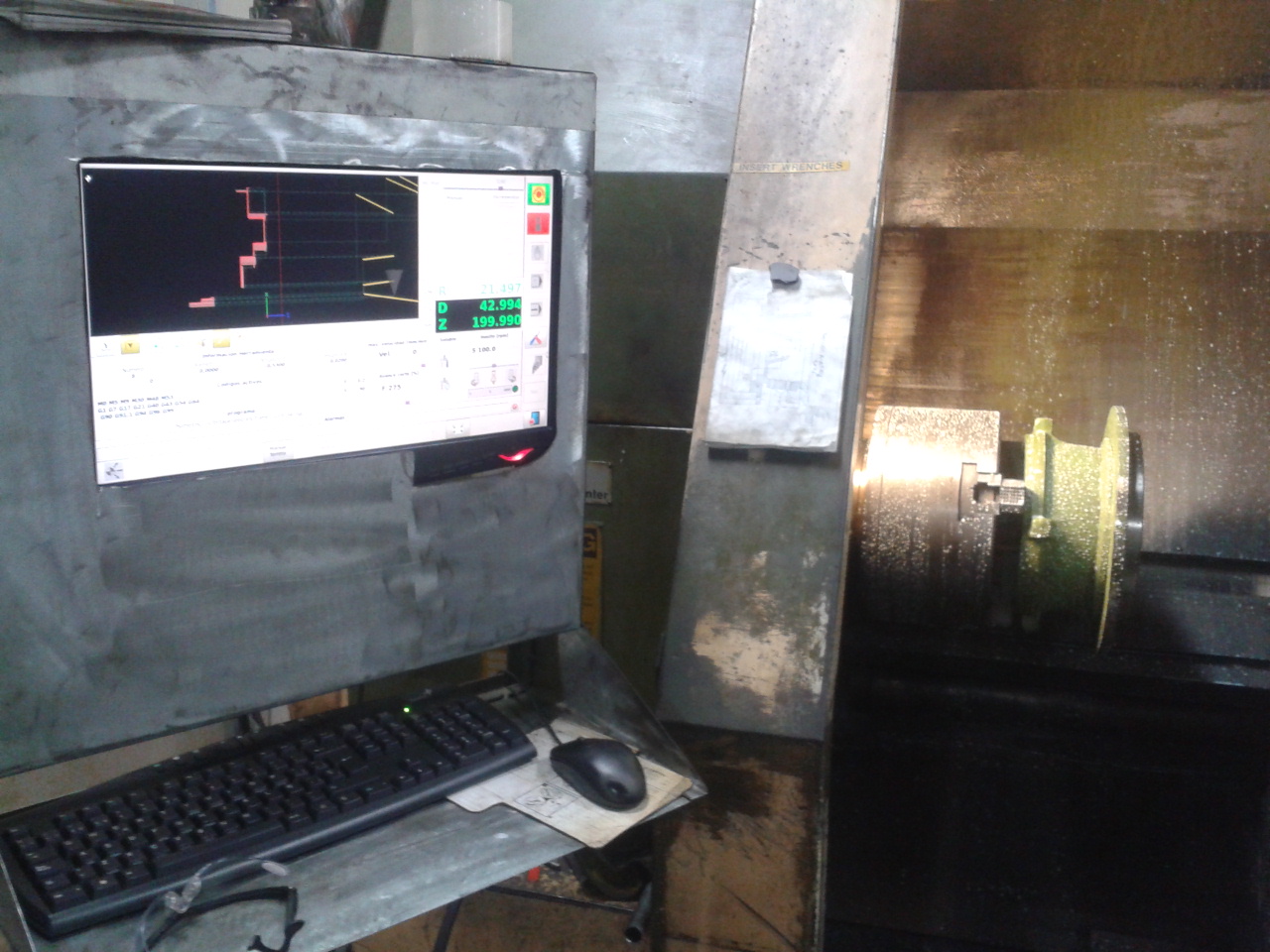

24 May 2013 23:03 - 25 May 2013 00:31 #34646 by jlviloria
Replied by jlviloria on topic Gmoccapy - A new screen for linuxcnc
Norbert,
I had the same problem of Marius, when he felt fullscreen, did not open completely.
I did that and it worked perfect. i'm using Gmoccapy 0.9.3, I is working perfect, with some changes as you noticed.
1) change the position of the tool table.
2) remove the macros
3) change the starting position of the button home_all
4) add keyboard functions with the Control key. (F3 home) (F9 = manual) (F10 = mdi) (F11 = auto) (F12 = tooltable) (Ctrl_R = run) ("Escape" = stop program) etc.
5) Change the run-from-line (the copy of GScreen of Cmorley) for my need.
6) Add some buttons for my machine, jog turret, turret home, cycle time and local time.
Hi marius,
Not as fancy, but functional.
Please, How do you add NGCGUI?
Thanks for all your help.
Jorge Viloria
Last edit: 25 May 2013 00:31 by jlviloria.
24 May 2013 23:58 - 24 May 2013 23:59 #34647 by mariusl
Replied by mariusl on topic Gmoccapy - A new screen for linuxcnc
Jorge
I dont see your picture. Did you attach it correctly? I would like to see what you did.
Regards
Marius
www.bluearccnc.com
Last edit: 24 May 2013 23:59 by mariusl.
