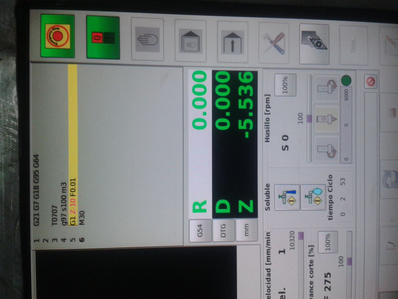

Please do not use G95, nor in gmoccapy or either gscreen!!!!!!!
There is an error witch I do not find at the moment, I will mail today to Chris and ask for help!
Here are the details:
If you enter in MDI
G21
G95 F0.01 S450 M3
G1 Z-10
The feed should be 0.01 mm / rev, with the spindle speed of 450 rpm this should give you a feed of 4,5 mm/min, but you will get 270 mm / min.
As you see the value is multiplied by 60!

28 May 2013 01:24 - 28 May 2013 01:29 #34774
by jlviloria
Replied by jlviloria on topic Gmoccapy - A new screen for linuxcnc
Norbert
None label shows the actual feed. show erroneous values.
The machine when running command G95, an alarm went out, I got to comment on these two lines and work.
def on_scl_feed_value_changed(self, widget, data=None):
feed_override = self.widgets.scl_feed.get_value() / 100
#real_feed = round(int(self.widgets.active_feed_label.get_text()) * feed_override)
#self.widgets.lbl_feed_act.set_text("F %d" %real_feed)
self.emc.feed_override(feed_override)
lbl_feed_act = disabled
lbl_current_vel = erroneous
but the machine moves well, at least as axis or industrial
I have my record the machining times have not changed.
attached my files.
Image Check the "tiempo ciclo" you see that just goes for 5 and takes more than 2 minutes

28 May 2013 02:26 #34782
by newbynobi
Replied by newbynobi on topic Gmoccapy - A new screen for linuxcnc
Jorge,
with the values you entered the cycle time must be about 10 minutes, but your cycle time is only 2 min 53 so IMHO the G95 cycle is not working correct.
By the way, I like the cycle time frame, can you mail me the corresponding code?
An about the max Vel , I could not find any error in your config, so if you jog both axis at ones with G0 the actual speed label should indicate something around 10000 mm/min and not only 6000.
I will check tomorow my code, may be I limited the values in some code snipped.
Norbert
