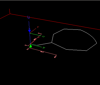

- cx4359481
- Visitor
25 Apr 2014 10:22 #46299
by cx4359481
Replied by cx4359481 on topic Gmoccapy - A new screen for linuxcnc
foam XYUV ?
- newbynobi
- Posts: 1931
- Thank you received: 394
25 Apr 2014 18:00 #46305
by newbynobi
Replied by newbynobi on topic Gmoccapy - A new screen for linuxcnc
Hallo nameless,
YXUV is has not been implemented yet, but can easily be done.
What are the special needs for a foam cutter? Do you just need the mentioned Joints/axis, or special temperatur and settings parameter?
Look at gmoccapy plasma more a stronger modified version, and also the embedded tabs section of the WIKI mayy help.
If there are more people interested in a XYUW Version of gmoccapy, I may include code for that.
Norbert
Norbert
- cx4359481
- Visitor
25 Apr 2014 18:54 - 25 Apr 2014 19:07 #46307
by cx4359481
gscreen:
GEOMETRY = xyuv
FOAM =1
[TRAJ]
AXES = 9
COORDINATES = X Y U V
[AXIS_0]-[AXIS_8]
HALFILE = core_sim9.hal
HALFILE = axis_manualtoolchange.hal
HALFILE = simulated_home.hal
HALFILE = locking_indexer.hal
foam.ngc
err
gmoccapy?
GLADEvcp widgets
hal_action_open
GEOMETRY = xyuv
FOAM =1
[TRAJ]
AXES = 9
[AXIS_0]-[AXIS_8]
foam.ngc
err
gmoccapy?
GLADEvcp widgets
hal_action_open
Last edit: 25 Apr 2014 19:07 by cx4359481.
