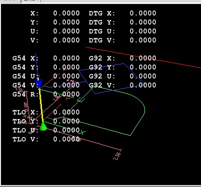

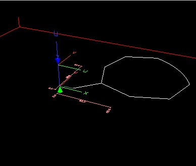

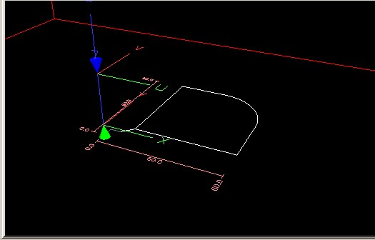

I use the widgets happened this errors;
When i config GEOMETRY = xy; The XY axles shows right.Or i config GEOMETRY = uv,The UV axles shows is also right.
But when i config GEOMETRY = xyuv,It shows wrong.
I upload three pictures.The 1.jpg shows the ideal sitatution. 2.jpg is that i config GEOMETRY = xyuv. 3.jpg is that i config GEOMETRY = xy.
I hope you can help to solve this problem
Thanks a lot!
Niu

Norbert is the creator of Gmoccapy and he wrote this in an earlier post
YXUV is has not been implemented yet, but can easily be done.
What are the special needs for a foam cutter? Do you just need the mentioned Joints/axis, or special temperatur and settings parameter?
Look at gmoccapy plasma more a stronger modified version, and also the embedded tabs section of the WIKI mayy help.
If there are more people interested in a XYUW Version of gmoccapy, I may include code for that.
Although Gmoccapy can handle 4 axis configurations, I dont know about the foam config. You must also see what kinematics are required for the foam cutting. Maybe look at gantrykins (not sure though).
Does your setup work with Gscreen at the moment?
Regards
Marius
A "Foam Cutter" view is an option in Axis.
www.linuxcnc.org/emc2/index.php/english/...-stepconf-test#40952
Has a screenshot of what it looks like.

26 Apr 2014 00:02 #46321 by cx4359481
Replied by cx4359481 on topic Gmoccapy - A new screen for linuxcnc
Hi!
This is use "Axis GUI",I want to use "gmoccapy" or "gscreen" to achieve XYUV control。

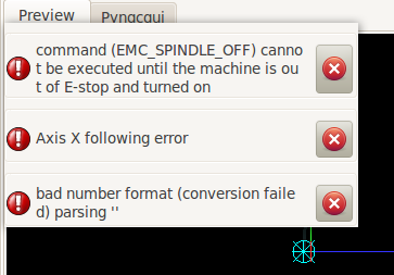

26 Apr 2014 23:29 #46341 by mariusl
Replied by mariusl on topic Gmoccapy - A new screen for linuxcnc
Hi Norbert
I did a fresh pull today and after compiling I tested a ngcgui file I have been working on. Before the update it worked ok but after the update I get these errors.
this is the file I am running. The stuff that is commented out in at the top is the next things to test via remap.
File Attachment:
File Name: seal_a.ngc
File Size:6 KB
Regards
Marius
www.bluearccnc.com
