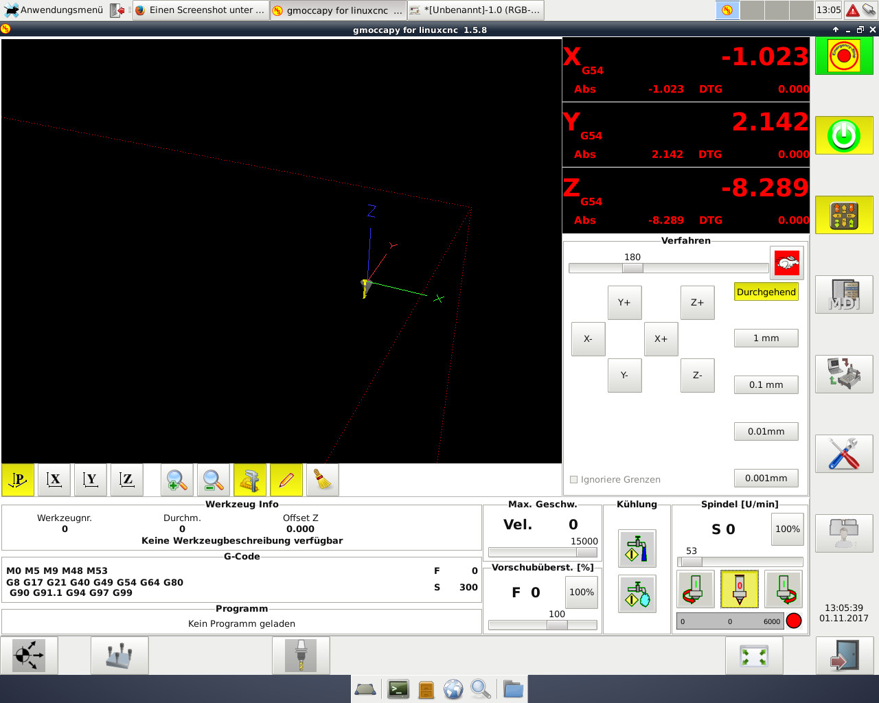

I have many pyvcp panels in the old pyvcp.hal System, that is my Proplem.

That is not the problem, we can make a new panel with GladeVCP and add that one to gmoccapy, but first we need to get the GUI to start.
Do you need all stuff from the pyVCP panel?
IMHO not, as some parts are already included in gmoccapy,
i.e.
the mode indications with the side buttons
spindle feedback
Norbert
i.e.
spindle feedback
Norbert
Last edit: 01 Nov 2017 11:39 by newbynobi.

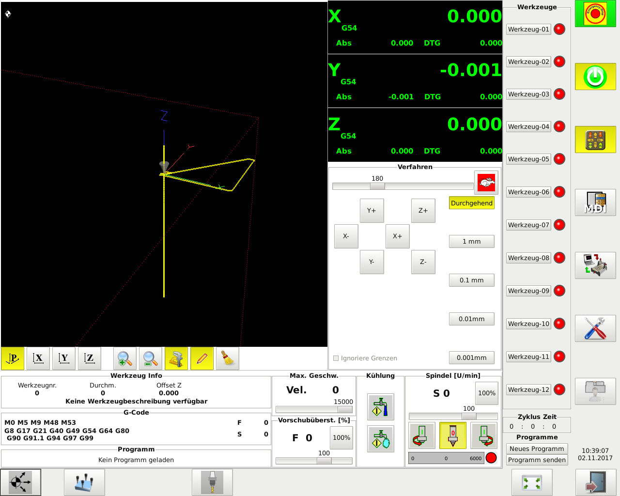

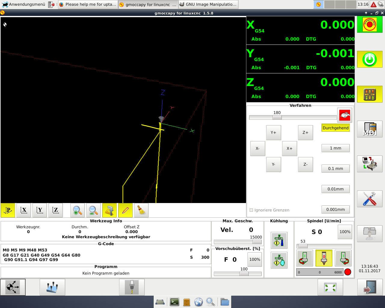

OK, next step, the side panel:
Copy the attached files:
Weiler_810T_panel.hal
Weiler_810T.glade
to your config dir:
Open your INI file and add in the [DISPLAY] section
After starting the GUI it should look like this
Weiler_810T.glade
to your config dir:
EMBED_TAB_NAME = Weiler_810T
EMBED_TAB_LOCATION = box_right
EMBED_TAB_COMMAND = gladevcp -x {XID} -H Weiler_810T_panel.hal Weiler_810T.gladeAfter starting the GUI it should look like this

Ok , next time crashed
**** GMOCCAPY GETINIINFO ****
No DEFAULT_SPINDLE_SPEED entry found in [DISPLAY] of INI file
**** GMOCCAPY INFO ****
**** Gmoccapy Glade 2 Datei gefunden ****
**** Audio Meldungen verfügbar ****
**** Keine virtuelle Tastatur installiert, geprüft wurde nach <onboard> und <matchbox-keyboard>.
**** Keine gültige Werkzeugvermessungs Konfiguration in der INI Datei ****
**** Werkzeugvermessung wurde außer Kraft gesetzt ****
**** GMOCCAPY INFO: Gcode.lang found ****
**** GMOCCAPY INFO : inifile = /home/chiron/linuxcnc/configs/hm2-servo/5i20.ini ****:
**** GMOCCAPY INFO : postgui halfile = gmoccapy_postgui.hal ****:
Killing task linuxcncsvr, PID=4884
Killing task milltask, PID=4971
task: 127 cycles, min=0.000014, max=0.012965, avg=0.009748, 0 latency excursions (> 10x expected cycle time of 0.010000s)
Debug file information:
/usr/bin/gmoccapy:237: GtkWarning: Invalid icon size 48
self.widgets.window1.show()
Weiler_810T_panel.hal:49: Signal 'Zyklus-Sekunden' of type 'u32' cannot add pin 'Weiler_810T.lbl_Sekunden' of type 's32'
'halcmd -f Weiler_810T_panel.hal' exited with 1
(gmoccapy:4974): GtkSourceView-CRITICAL **: gtk_source_language_manager_set_search_path: assertion `lm->priv->ids == NULL' failed
HAL: ERROR: function 'time.0' may only be added to one thread
gmoccapy_postgui.hal:32: addf failed
4884

OK, I corrected the hal pin type in the glade file, just replace the file in your config with the attached one and inform:
Norbert

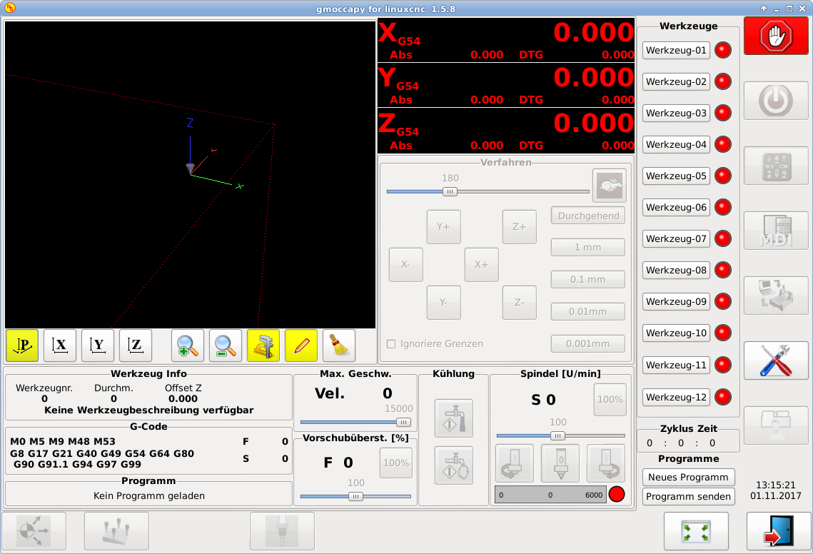

Ok, next step ,Maschine runs Werkzeug is on but no funktion.
Any Idea ?
Any Idea ?
- newbynobi
- Posts: 1931
- Thank you received: 394
02 Nov 2017 10:39 - 02 Nov 2017 10:42 #101183
by newbynobi
Replied by newbynobi on topic Please help me for uptate axis 2.5.4 to Gmoccapy
strange
Did the Werkzeugwechsler work on this machine/computer with axis?
The only thing we changed in the config was the pyvcp panel to be a glade panel. I do not see any reason, why it should not work as expected. OK in the glade panel we did not connect the halui.is-mdi nor halui.is-auto signals, but both are only needed in Spindle.hal
and is-MAN is connected in Werkstuekwechsel.hal.
So IMHO at the moment the spindle should not work. That could lead to a non working tool change, because the spindle is in wrong orientation.
So please add in i.e. Spindle.hal:
Does the spindle work?
Can you try a tool change in MDI Mode?
Norbert
P.S. Do you have teamviewer on the computer? I could connect to you to analyze the hal pin connections.
Where are you located? I expect you to be in Germany, as myself.
net IS-MDI halui.mode.is-mdi
net IS-AUTO halui.mode.is-autoDoes the spindle work?
Norbert
