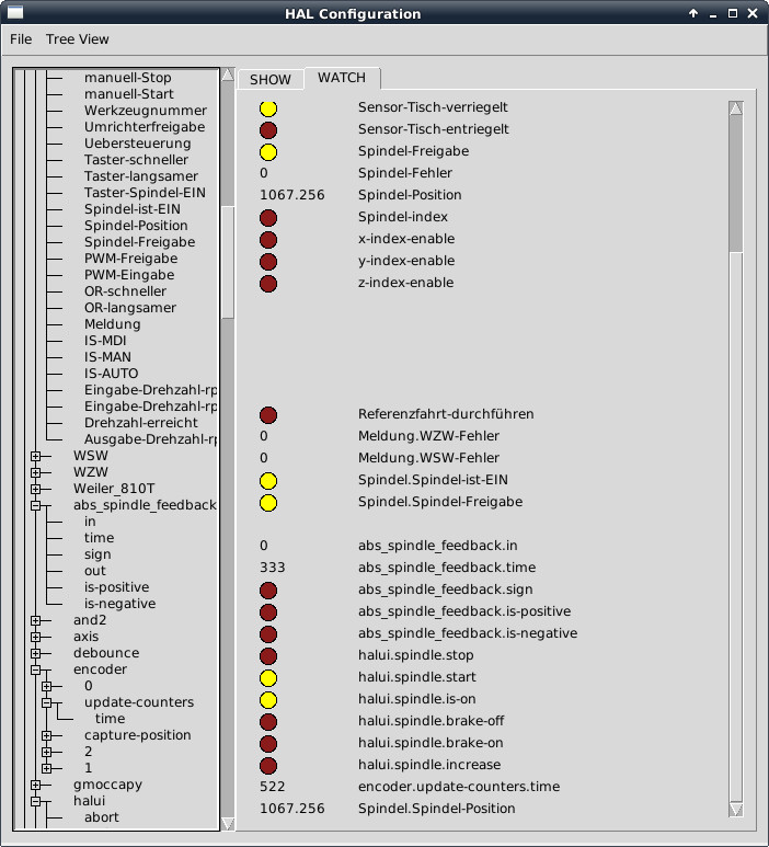

Hallo Siggi,
if you go to the settings page of gmoccapy (code = 123) (button with the tools on it), you can push the button "halshow" and within that program you can watch the hal pin.
Norbert
Norbert

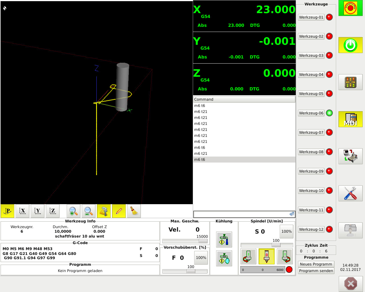

02 Nov 2017 13:57 #101191
by Weiler810T
Replied by Weiler810T on topic Please help me for uptate axis 2.5.4 to Gmoccapy
- Weiler810T
- Visitor
02 Nov 2017 14:14 - 02 Nov 2017 14:22 #101193
by Weiler810T
Next Proplem, Spindel is on but not not enough speed , max 500 U/min
Last edit: 02 Nov 2017 14:22 by Weiler810T.

02 Nov 2017 14:45 - 02 Nov 2017 14:48 #101194
by newbynobi
Replied by newbynobi on topic Please help me for uptate axis 2.5.4 to Gmoccapy
Spindel.hal you added the commands, but commented out at the same time other important stuff
Please change the "Betriebsmodus" partto be like mentioned above!
Norbert
net
net IS-MDI halui.mode.is-mdi
net IS-AUTO halui.mode.is-auto
net IS-MAN => Spindel.IS-MAN
net IS-MDI => Spindel.IS-MDI
net IS-AUTO => Spindel.IS-AUTOPlease change the "Betriebsmodus" partto be like mentioned above!
Norbert
Last edit: 02 Nov 2017 14:48 by newbynobi.
- newbynobi
- Posts: 1931
- Thank you received: 394
02 Nov 2017 15:01 - 02 Nov 2017 15:02 #101195
by newbynobi
I just noticed, if you just push the button spindle on, without having given a S value, the spindle will start with the default speed, you set on the settings page from gmoccapy.
Check the value in the gcode information frame!
Please try S3000 M3 from MDI.
Does that give a more convenient speed?
You need to set on the settings page also your max and min spindle velocities, actual it is set to 6000 rpm max.
Norbert
Norbert
Last edit: 02 Nov 2017 15:02 by newbynobi.
