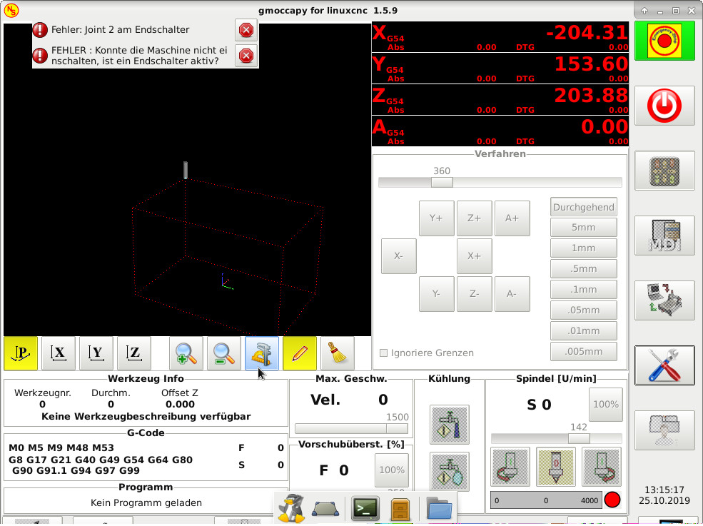

My mill uses compressed air to compensate the weight of the z-axis. After shutdown the Z-axis sits on the Limit-Home switch an I used to check the "Ignore Limits" in the jogging screen to move the axis off the switch. Now for some reason (and after quite a bit of changing other stuff in the HAL and INI) I can't check the box as it is grayed out.
Is there a setting somewhere concerning the "Ignore Limits" checkbox being active or not?

So here we are:
The machine sits on the Z-Limit/Home switch and I cant start the machine (F2). The errors are:
"Error: Joint 2 on limit switch"
"ERROR: Can't start machine. Is there a limit switch active?"
So I have to change the HAL and set the display to "axis", comment out the gmoccapy-postgui.hal and restart LinuxCNC with axis screen and I can check the "Ignore Limits" checkbox and move the axis oft the limit switch.

Solved.
In gmoccapy as opposed to axis I have to go into E-Stop an out again for the "Ignore Limits" checkbox to become available.
