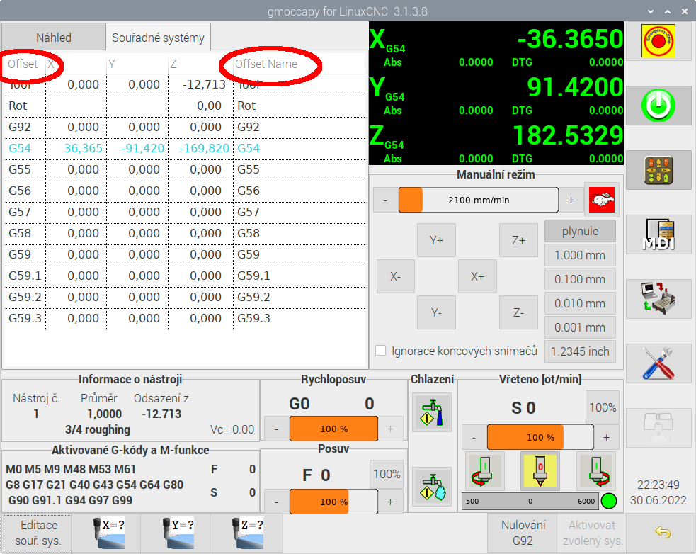

I work on translate to czech, but I cant translate stuff in offset page:
src/po/gmoccapy/cs.po - it looks good, but it is not working too

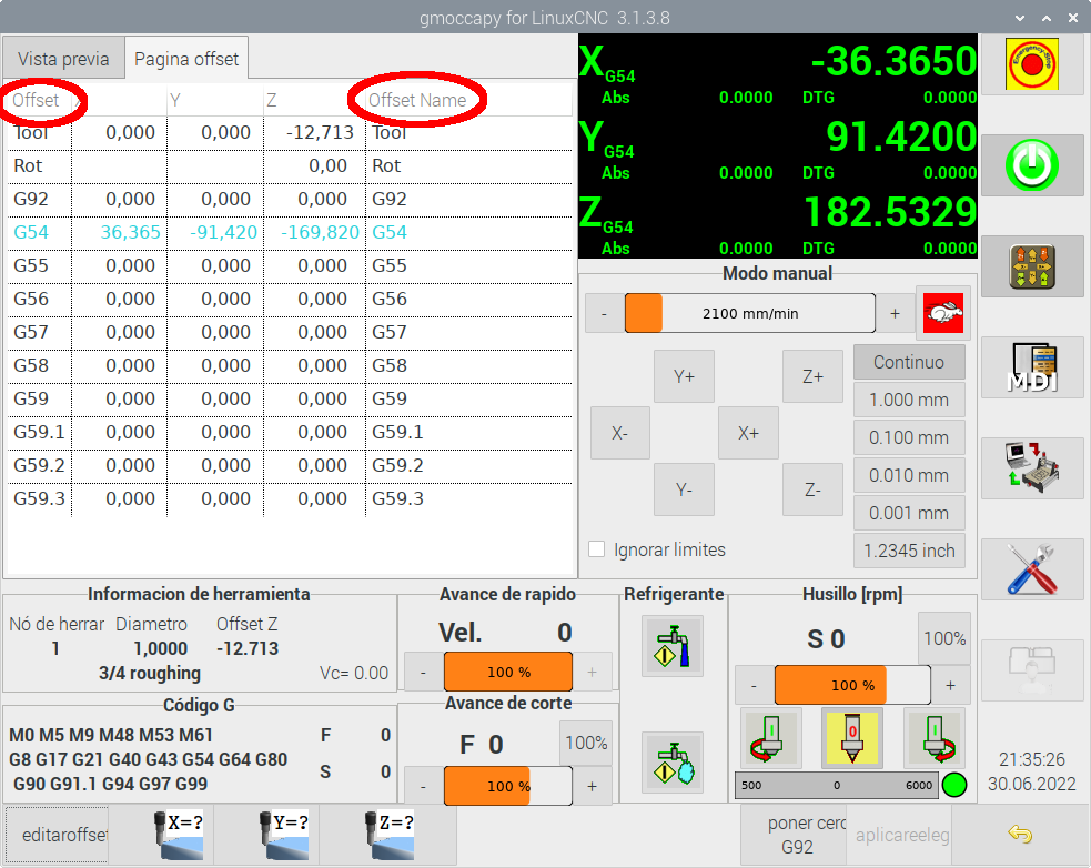

I tried espanol:
src/po/gmoccapy/es.po - it is wierd "../../../"
#: ../lib/python/gladevcp/offsetpage.glade.h:27
msgid "Offset Name"
msgstr "Pojmenování"I tried espanol:
#: ../../../../lib/python/gladevcp/offsetpage.glade.h:27
msgid "Offset Name"
msgstr "Nombre offset"Attachments:

I'd do anything to fix LCNC, but I'm not a programmer. I couldn't find anywhere how translations with *.po work. There are a bunch of articles about translating *.po files. But nowhere is it explained how pot files are created, and what the compiled *.mo files do.
Replied by zz912 on topic Translate offsetpage.glade.h - dont work
I don't know what to look at.Maybe you could look?
This?
cs.po
#: ../lib/python/gladevcp/offsetpage.glade.h:26
msgid "Offset"
msgstr ""
"Souřadný\n"
"systém"I'd do anything to fix LCNC, but I'm not a programmer. I couldn't find anywhere how translations with *.po work. There are a bunch of articles about translating *.po files. But nowhere is it explained how pot files are created, and what the compiled *.mo files do.

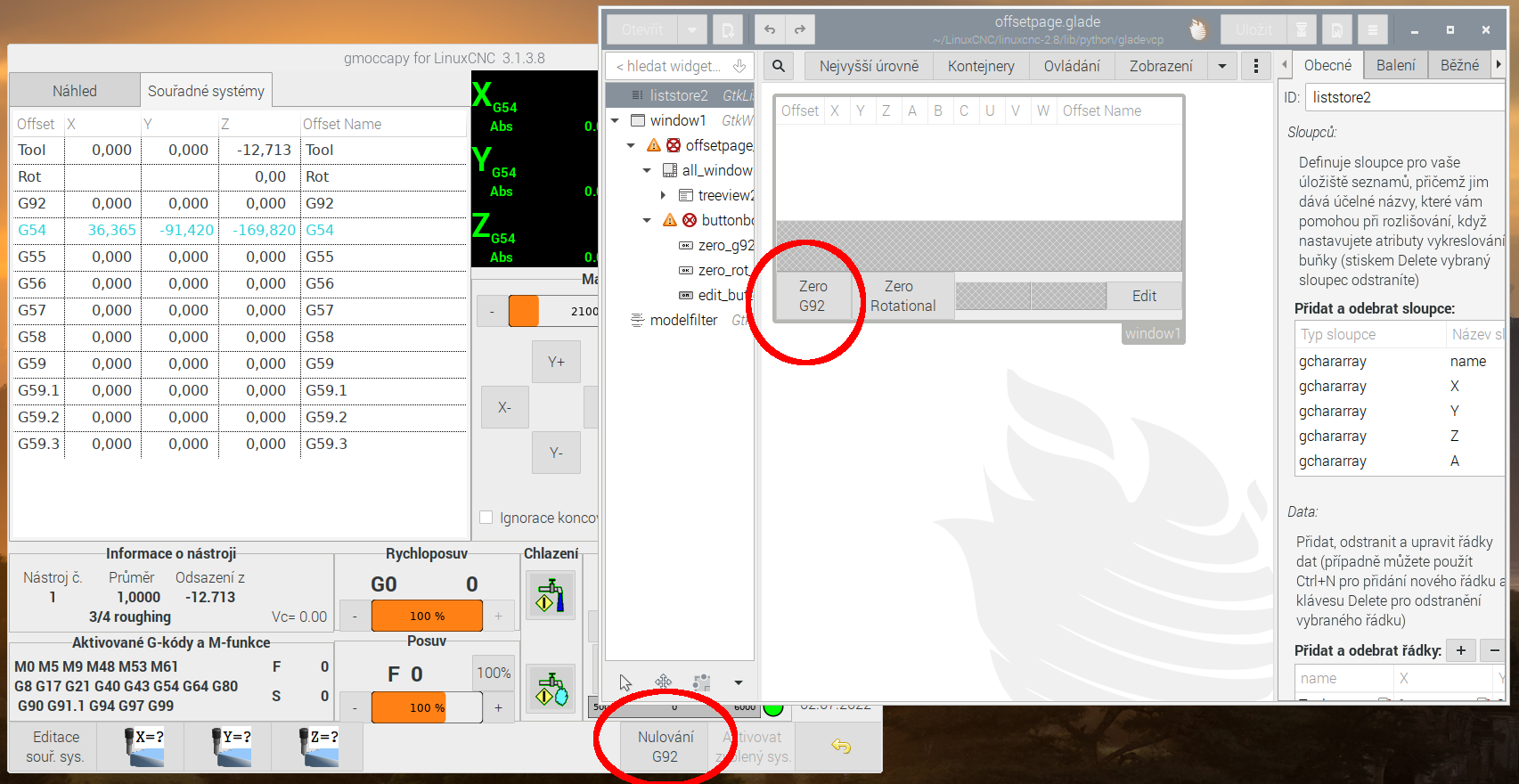

02 Jul 2022 20:33 - 03 Jul 2022 10:39 #246466
by zz912
It's rather odd as it seems that other things are being translated, just not the column headers.
looks like you are right
Edit: This picture is wrong. Gmoccapy has own Zero G92 button. offsetpage.glade.h has own Zero G92 button.
