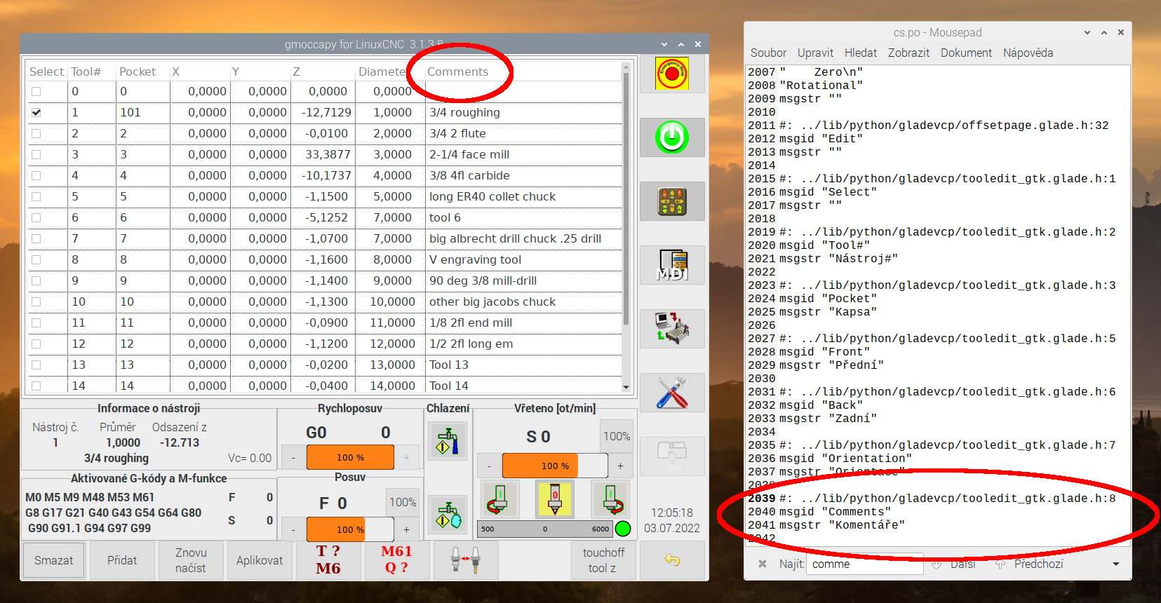

I made special file src/po/cs.po:
In src/po/gmoccapy/cs.po were this line deleted.
Nothing happen

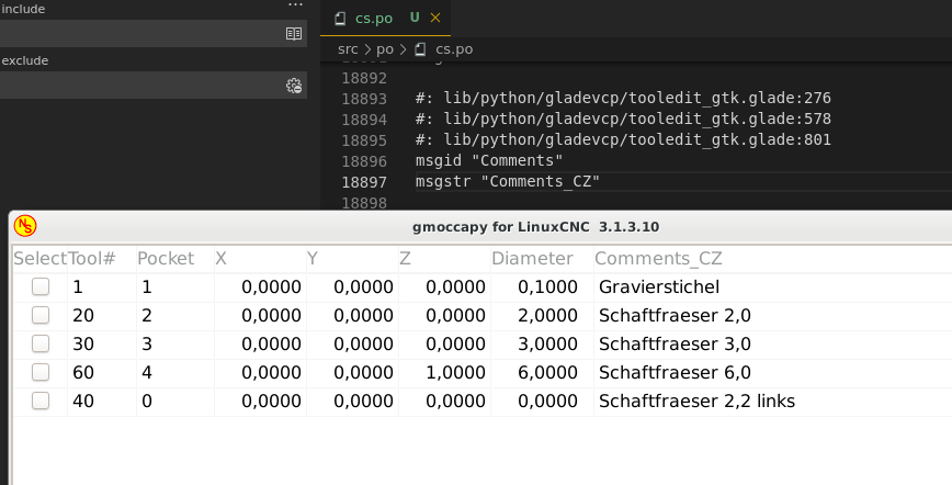

27 Jul 2022 12:13 - 27 Jul 2022 12:17 #248413
by HansU
Unfortunately not.
The same for "Comments"
I tried with a cs.po file and it worked for me:
</div></blockquote></div></blockquote>
Replied by HansU on topic Translate offsetpage.glade.h - dont work
Can weblate be used for version 2.8?
I use Poedit
Unfortunately not.
tooledit_gtk.glade.h - have the same problem
