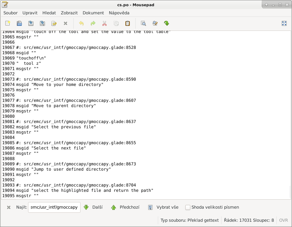

27 Jul 2022 20:31 #248460 by zz912
Replied by zz912 on topic Translate offsetpage.glade.h - dont work
I made
/home/zdenek/linuxcnc/linuxcnc-2.8/src/po/cs.po file
from linuxcnc.pot
I found, that it duplicate
/home/zdenek/linuxcnc/linuxcnc-2.8/src/po/gmoccapy/cs.po file
Is this duplication intentional?

27 Jul 2022 20:49 #248464 by zz912
I have another problem.
My src/po/cs.po file is not same as your src/po/cs.po file.
My src/po/cs.po file dont contains
"Comments" or "Offset Name"
Could you please remove your linuxcnc.pot , rebuild LCNC and check it?
27 Jul 2022 21:24 #248470 by HansU
Replied by HansU on topic Translate offsetpage.glade.h - dont work
What do you mean with this? These two cs.po files should be completely different. One derived from gmoccapy.pot, the other from linuxcnc.pot
But it should. Look into linuxcnc.pot, it does contain these strings.

27 Jul 2022 21:40 #248471 by zz912
I agree with what you write. My error looks like the tool that generates the linuxcnc.pot file went wrong.
In my linuxcnc.pot file is merged gmoccapy.pot file.
I made /src/po/cs.po file from linuxcnc.pot
Are you working on branch 2.8?

28 Jul 2022 06:33 #248510 by zz912
You probably use branch 2.9
linuxcnc.pot 2.9 contains
doesnt have duplicate strings with gmoccapy.pot
linuxcnc.pot 2.8 or 2.8.2 doesnt contains
28 Jul 2022 10:39 #248521 by HansU
These strings were moved from gmoccapy.pot to linuxcnc.pot in 2.9.
But they seem to have no effect for 2.8.
This needs some deeper investigation I guess.

05 Aug 2022 15:20 - 06 Aug 2022 20:49 #249122 by HansU
I figured out, that it was fixed in master by chance when I made the glade file for the calculator translatable. That was this commit: github.com/LinuxCNC/linuxcnc/commit/921c...8fe2b2e82eddbb44314e
The important line here is
locale.bindtextdomain("linuxcnc", LOCALEDIR)
If you add this line to gmoccapy.py after line 141 (locale.bindtextdomain("gmoccapy", LOCALEDIR)) then it uses the string from src/po/cz.po for the GUI. But if you run 'make pofiles' the string moves to gmoccapy/cz.po. Probably something wrong with gettext or so.
Might be related to this change: github.com/LinuxCNC/linuxcnc/pull/542
But even taking the Submakefiles from master didn't resolve this. A bit weird and I am not so deep in how that works with gettext for glade etc.
I already spent too much time on that little issue for a version that is only bugfixed.
Even I if I had a patch that is bigger, it might be no good idea to apply it on a stable version as it is more an enhancement than a bugfix.

06 Aug 2022 20:07 #249221 by zz912
1) I appreciate you helping me with fixes in the stable version. It's probably not as much fun as developing new things, but I prefer to spend my time improving already good things.
2) I guess we didn't understand what I wanted from you. I didn't want to move Strings from gmoccapy.pot to linuxcnc.pot. I wanted to remove duplicates from linuxcnc.pot.
Thanks to your link I solved it:
github.com/LinuxCNC/linuxcnc/pull/1896
3) Thanks for this link:
I think that if I add " translatable="yes" " to some places, it won't be such a big hit.
