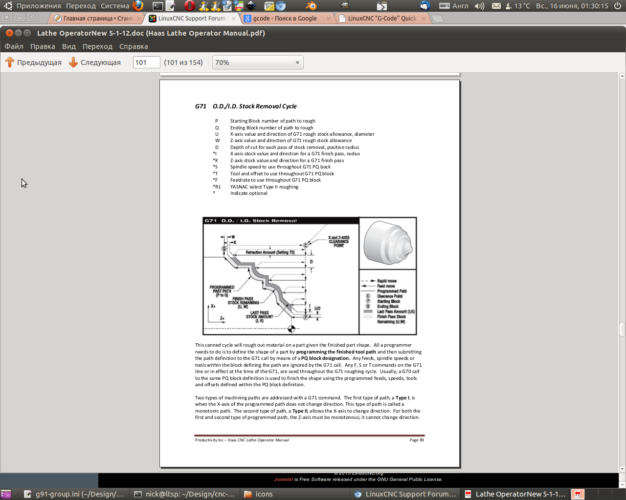

16 Jun 2013 04:31 #35696 by Nick
Thinking further of Lathe subroutines...
I have no experience working with them...
Are there any standard subroutines for lathe machining?
What about multipass cutting?
Is there something like G71 that I've found in HAAS lathe manual in LinuxCNC?
16 Jun 2013 05:00 - 16 Jun 2013 16:54 #35697 by Rick G
John, Arceye and others have posted some great ones in the ngcgui section. Inside taper, Outside taper, Inside diameter, outside diameter. Multi pass. profile cutting etc.
In fact some of us use ngcgui for over 90% of what we do on a lathe.
