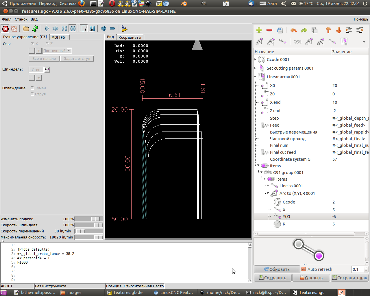

20 Jun 2013 02:54 #35815 by Nick
Replied by Nick on topic LinuxCNC Features - a kind of NGCGUI
I've found a bug, but do not know where is it, in linuxcnc or in it's docs
The docs says:
#<_x> - Return absolute machine X coordinate. Same as #5420.
(here www.linuxcnc.org/docs/devel/html/gcode/o...ub:system-parameters )
But if we run the following code we have got (0,0) all the time. So it looks like #<_x> is relative coordinates.
Can somebody check it on other versions of linuxcnc?
My is 2.6.0-pre...
G54
G10 L2 P0 X0 Z0
G1 X0 Z0
(DEBUG,  xy: #<_x>, #<_y>)
G10 L2 P0 X10 Z0
G1 X0 Z0
G10 L2 P0 X20 Z0
G1 X0 Z0
M02
PS We have a lot of new results on Features.
A lot of interface improvements and new subroutines for lathe. :)
