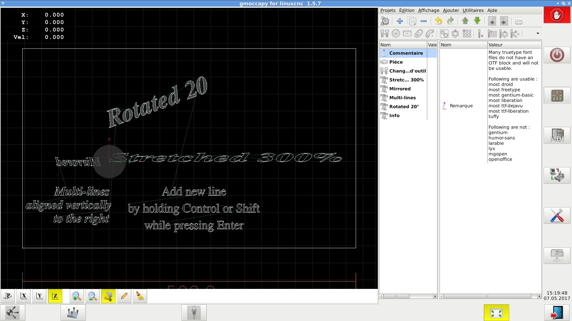

I just updated NativeCAM and here are some of the changes :
directory changes uses links instead of copies
user dir my-stuff
add gcode and fontname data type
add hiding of fields
add support for autosave current work
change from float or int to gcode type and revert back
improve popup menus
customizable toolbar and menu
custom defaults for values and display settings for ALL subroutines
support for testing new translation
better support for keyboard navigation
treeview2 rows expandable
setup prevent setup of nondeb if a deb is installed
nondeb_setup create links to language file
catalogs use a new format
cfg files :
add indexing 4th axis
add lead-out option
add gcode option in combo-user
add center position for Z axis in material
add appropriate icons
default_template when not defined
add mill examples : 4th axis and turnercube(2)
ngc files
improve Z-step calculation
improve lead-in and lead-out calc
support for full depth finishing pass
improve milling performance
update language files
numerous minor improvements and fixes

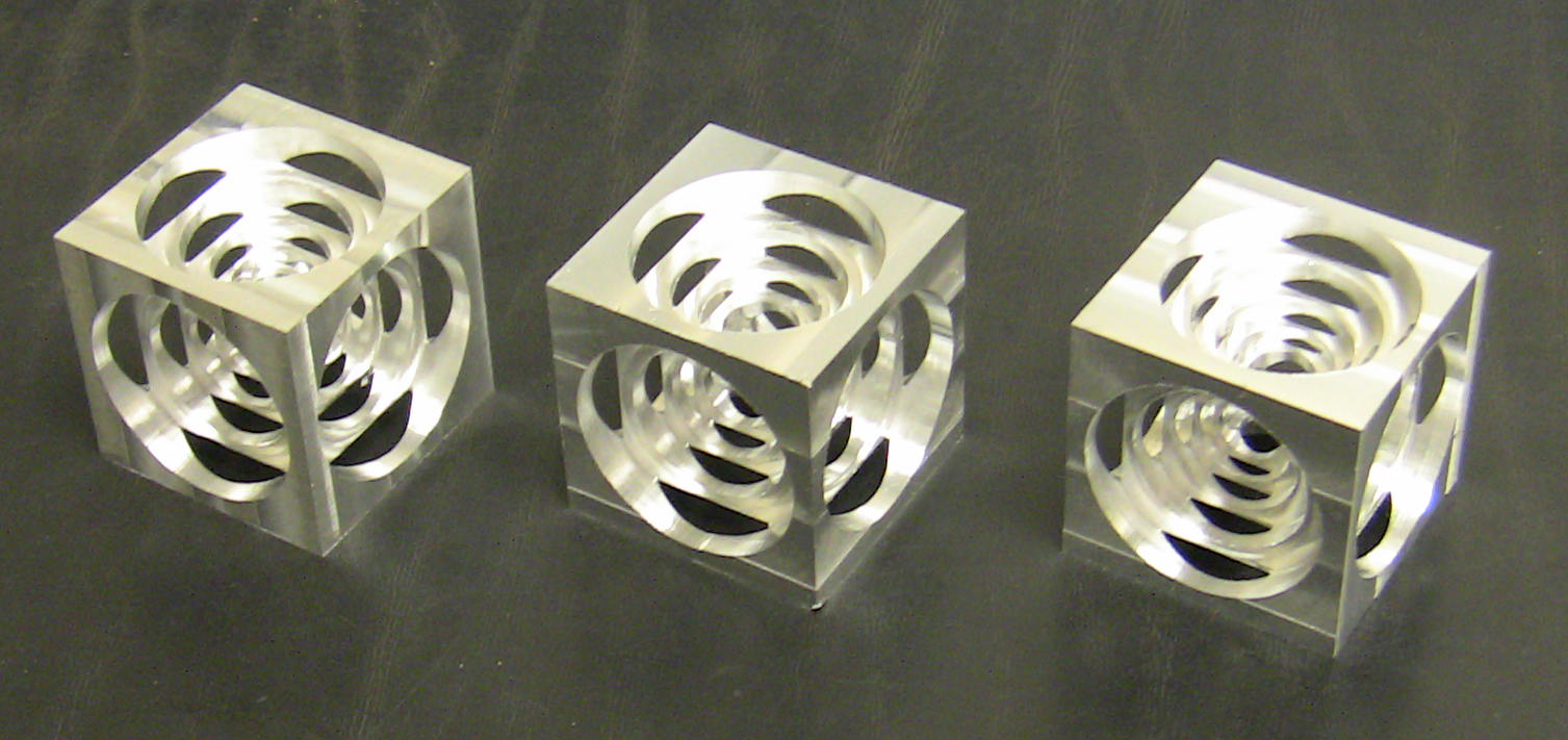

These are cubes I milled with the examples supplied :
Watch these videos :

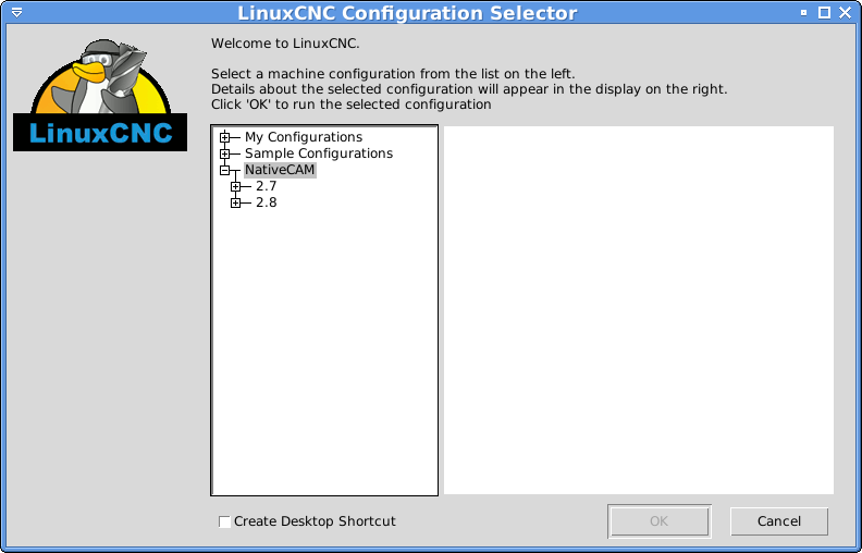

When I tried to run the command: linuxcnc inifilename per the README.md instructions linuxcnc opened up but there was no NativeCAM window on the right side of Axis and I got the following on the terminal after closing it:
So I went and looked in the NativeCAM/defaults folder and sure enough there was no lathe folder so I added it re-ran the command and then NativeCAM showed up. I checked the zip file on the github page, it also doesn't have that folder in it.
But then after subsequent runs it stopped showing up and I get this:
Any ideas what I did wrong?

I will add a simple readme file to it until I have something else to place in it. ncam.py is programmed to copy all the required files but the directory is not there and the error you got. Creating a 'lathe' dir was the thing to do
I suggest you copy or create a short file in NativeCAM/defaults,
Delete '/home/bogie6040/linuxcnc/configs/BRIDGEPORT_7I76/ncam'
and restart
Keep me informed
Fern

Hi Bogie
I just pushed updates that should correct the error and report clearly if an error happens when copying or creating link
Regards
Fern

Run everything in a terminal and pay attention to what you see. Post what is displayed on your screen if you suspect it shows a problem, it will help me help you.
To see if your lcnc version can use the deb package, run this script :What happened to the .deb package?
$ linuxcnc_var all
When available, expected system directories are:
LINUXCNC_AUX_GLADEVCP=/usr/share/linuxcnc/aux_gladevcp
LINUXCNC_AUX_EXAMPLES=/usr/share/linuxcnc/aux_examples
Only pre-release version can use the deb package until release of version 2.9
Regards

cncuser@debian:~$ linuxcnc_var all
LINUXCNCVERSION=2.8.0-pre1-3020-g71d5334
REALTIME=/etc/init.d/realtime
RTS=uspace
HALLIB_DIR=/usr/share/linuxcnc/hallib
cncuser@debian:~$
Hasn't installed anything, so where is the .deb?

- FernV
- Posts: 457
- Thank you received: 124
08 May 2017 13:52 #92816
by FernV
Replied by FernV on topic NativeCAM is Features renamed
Hi
Since you have a pre-release version, it can use a deb. If it is listed in the selector, you can use it but I do not think it would be the latest version
You can easily create your own deb with these commands :
open a terminal in NativeCAM/debian sub-dir
$ ./makedeb.sh
answer 'y' then Enter
$ cd ../..
$ sudo dpkg -i nativecam_0.1.1_all.deb
That is all
Now go to the sub-directory of your ini file
$ ncam -i your_ini_filename.ini
You should now have ncam stand-alone and see everything
$ linuxcnc your_ini_filename.ini
unless you have some other gladevcp config allready in this file, everything should work fine
I still have to clarify how the deb is distributed
Regards
Fern

- grump
- Posts: 158
- Thank you received: 10
08 May 2017 14:58 #92822
by grump
Replied by grump on topic NativeCAM is Features renamed
You must be seeing this through someone else's eyes cos it sure ain't mine.
I have a fresh install this morning and there is no NativeCam option anywhere in my configs.
I don't want to go down the route of creating my own deb only to find it don't work when finished.
I would just like to download the zip fie and follow some easy install steps, which I am sure if they were made available many others would do the same.
