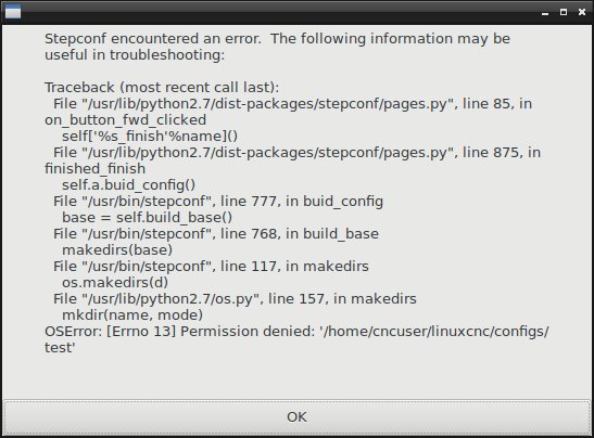

That is due to using "sudo" where you should have not used it, now Linuxcnc has no write permission to that folder.
Try this
Sudo thunar
If using debian wheezy or
Sudo nautilus
If using mint
Navigate to Linuxcnc folder located in your home folder ( usualu when thunar or nautilus opens, you get desktop documents and linuxcnc ), right click on it and choose properties, select permisions in the uper portion of the window, change the permissions to read and write for user cncuser in your case.
Start stepconf, it should work as usual but linuxcnc might still have permission issues.
Try this
Sudo thunar
Sudo nautilus
If using mint

Cheers Tommylight that put me back on track.
It was actually because I was using a root terminal when I pulled and installed and not using sudo when should have but same meat different gravy init?

As a general rule, never use a root terminal, you cam do a lot of damage to the system and you do not get any warning. Sudo on a normal terminal will at least warn you if you are about to mess something up.

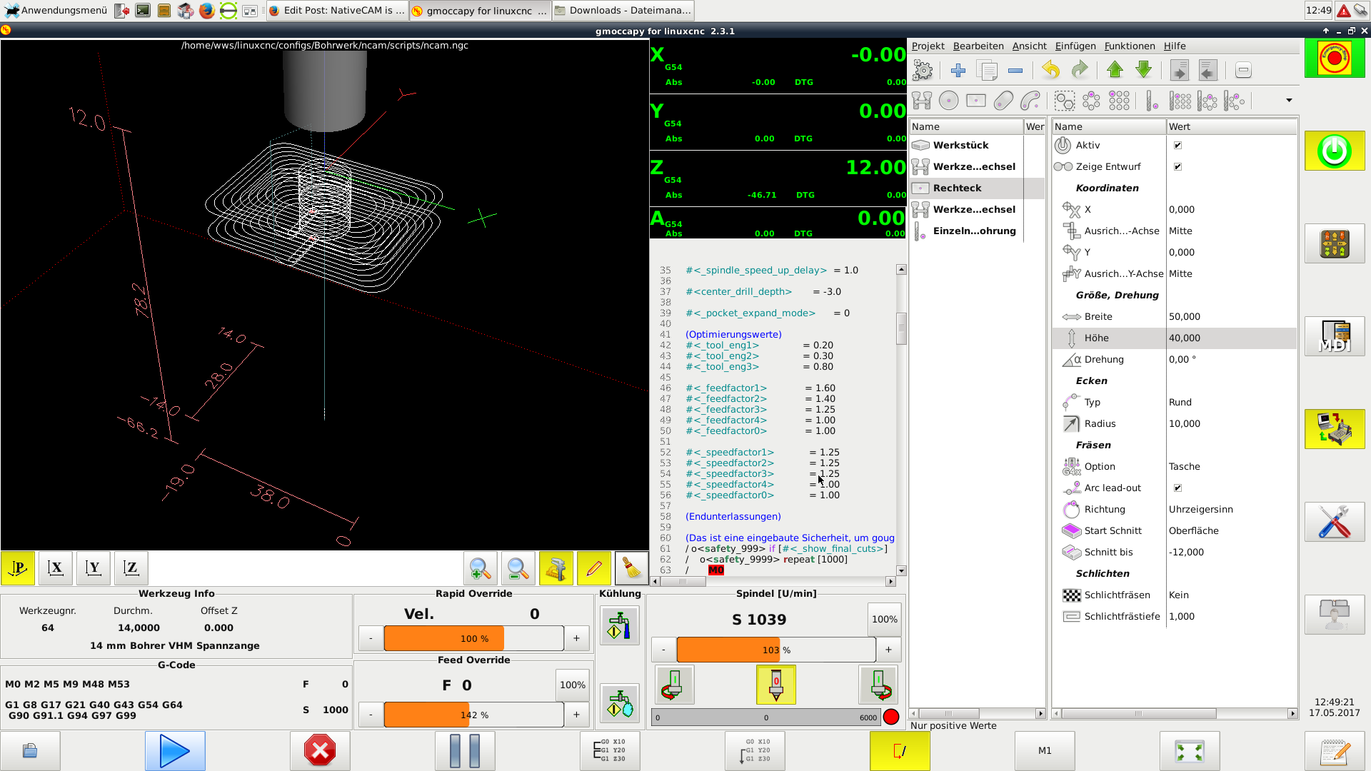

hi fernand.
it is posible ther is a littel bug with the engraphing?
when i want mill a word the first character is ok and the milling tool goes to z minus with G1 .
when lcnc starts the second character the tool goes to Z minus with G0 .
not so good for the lifetime of the tool.
pehaps its my mistake ?
nice greedings and thank you.
florian
florian

Hi Florian,
I do not see error in ttt file but I will check when at home.
Can you post ncam.ngc that has that error ?
Fern
Fern

I did not find a bug in the generated file but I found a few minor issues I will fix, like raising the mill at the end of a letter and plunging at vertical feed instead of normal.
Fern

hi fernand.
yes i think this is the problem that the tool goes to Z minus with the horizontal feed speed and not with the vertical.
here is my ncam.ngc
thanks a lot
florian
P.s.: the new milling subroutines are perfekt now!
here is my ncam.ngc
thanks a lot
florian
