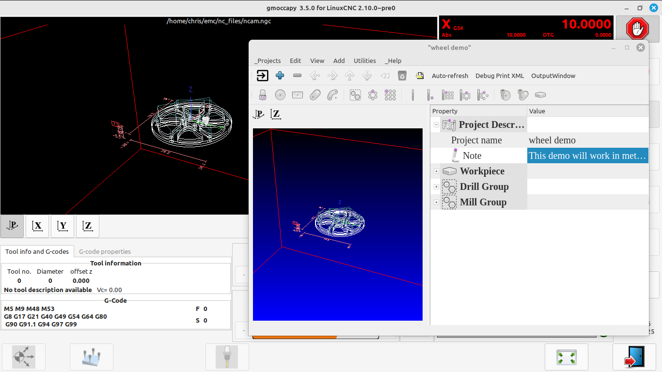

NativeCam on LinuxCNC 2.9.3
- vre
- Posts: 610
- Thank you received: 17
05 May 2025 13:11 #327757
by vre
Replied by vre on topic NativeCam on LinuxCNC 2.9.3
I have installed and works except lathe.
Why this project stalled ?

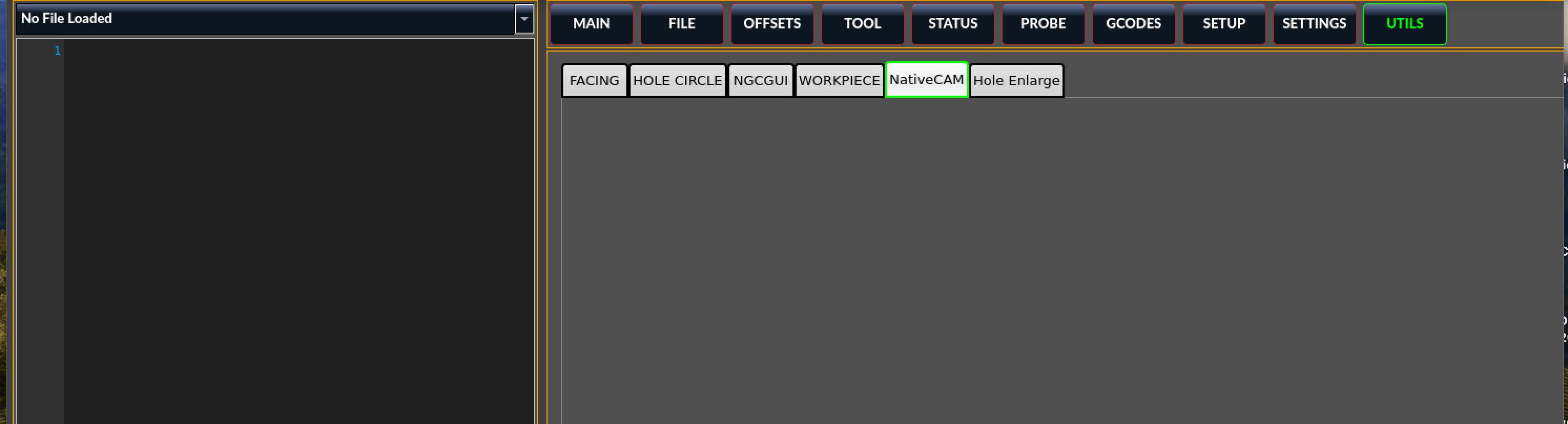

I've tried to run NativeCAM with qtdragon after a couple of changes:
# required NativeCAM item:
EMBED_TAB_NAME = NativeCAM
EMBED_TAB_LOCATION = tabWidget_utilities
EMBED_TAB_COMMAND = gladevcp -x {XID} -U --catalog=mill /usr/share/linuxcnc/gladevcp/NativeCAM/ncam.ui
And I copied an existing folder in qt_dragon config folder.
The NativeCam tab (empty) is shown, but NativeCAM wont'run cause it declares a DISPLAY problem.
I'll try to trick NativeCAM to avoid the display check, to see if it will run.
Regards
Giovanni

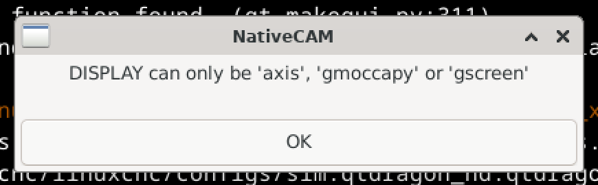

17 May 2025 21:48 - 17 May 2025 21:51 #328659
by Giovanni
Replied by Giovanni on topic NativeCam on LinuxCNC 2.9.3
The file attached is a dirty patch to test only with qt_dragon interface.
The DISPLAY test function is disabled to allow NativeCAM to run.
If you would try NativeCAM with qt_dragon, follow the installation procedure (search in previous messages)
Replace the ncam.py file with the attached and add the line in green in the .ini file:
It will run in a strange way:
LinuxCNC will start with the NativeCAM error. Click OK
NativeCAM will start (not embedded)
LinuxCNC screen shows up.
The NativeCAM tab is empty and useless, but to use NativeCAM use ALT-TAB keys to bring its window up.
After sending the program to LinuxCNC, use ALT-TAB keys to bring LinuxCNC up.
It's a terrible way to use it, but for now it at least works.
Regards
Giovanni

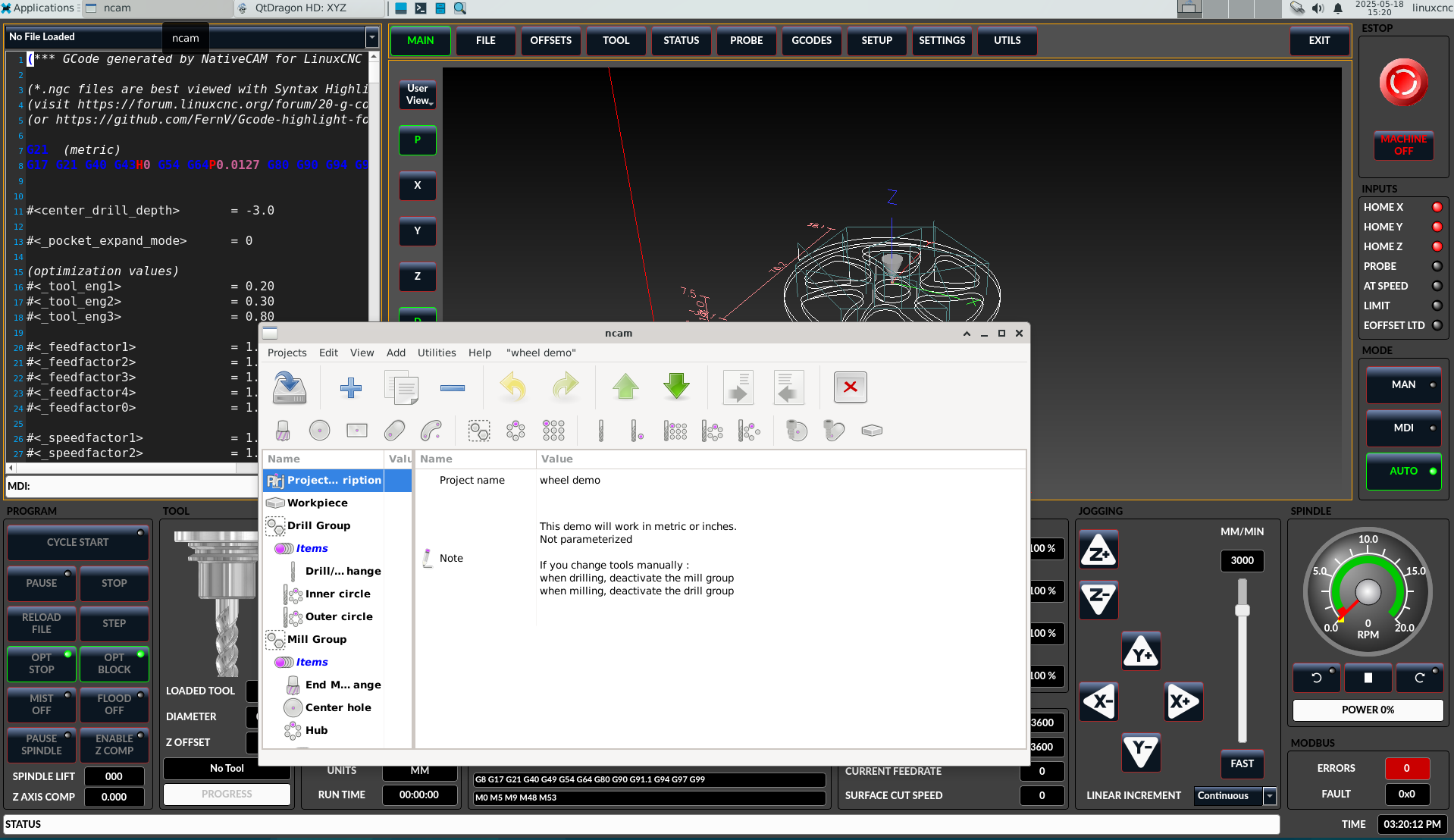

18 May 2025 10:23 #328682
Replied by cmorley on topic NativeCam on LinuxCNC 2.9.3
There is a slowly developing version for qt screens:
github.com/LinuxCNC/linuxcnc/commits/qt_ncam/

18 May 2025 10:42 - 18 May 2025 20:36 #328683
by Giovanni
Since a QT version is currently in development, I think it would be better to use that version for QT interfaces.whithout making strange combinations.
Regards
Giovanni

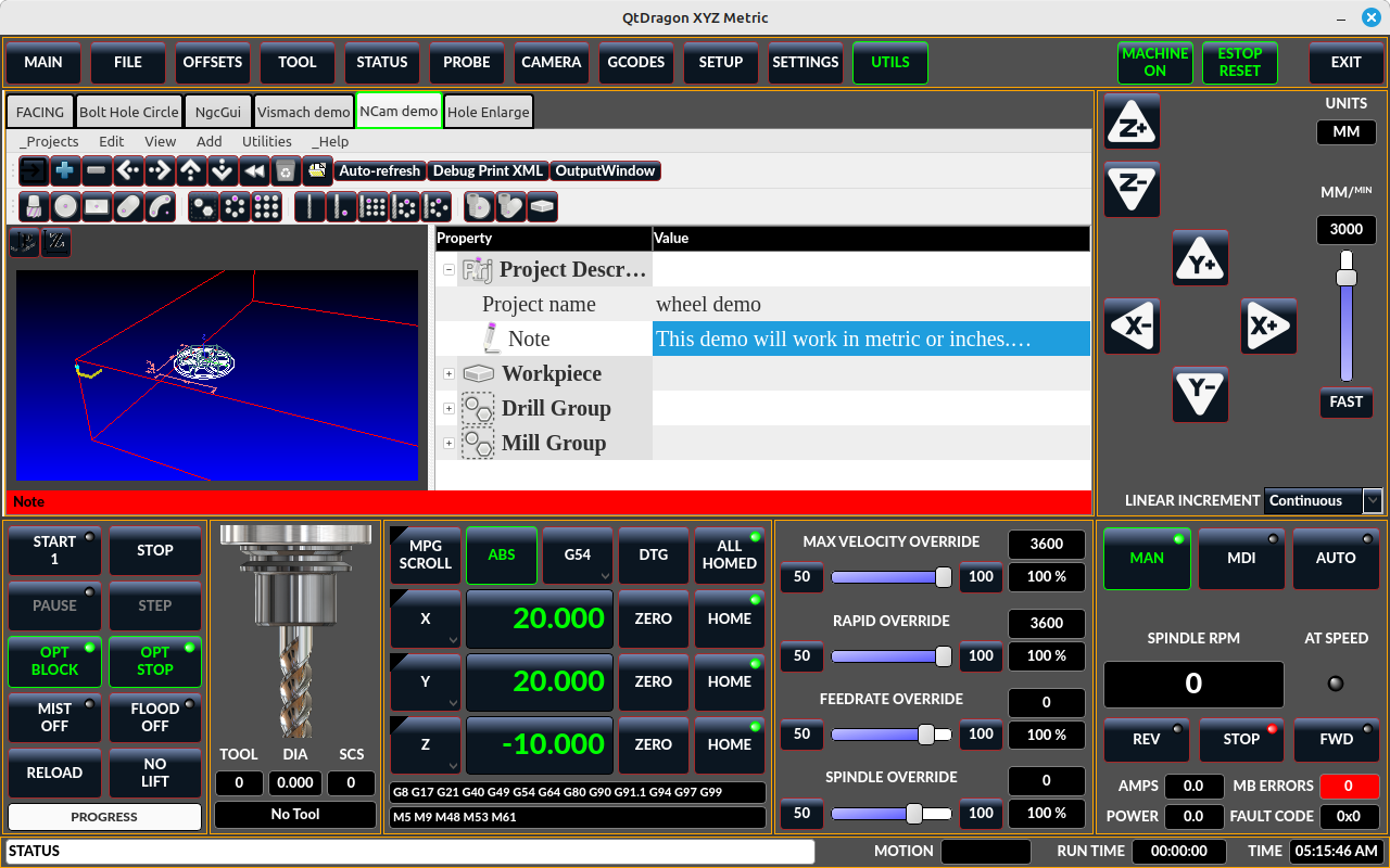

18 May 2025 13:16 #328691
by Giovanni
Yes it's a lot of work but it will be all QT.
You have to change at least all the interface.
That's a very good job.
"My" (note the quotes, cause it's not mine) version, the solution I proposed in the message above it's only the "standard" gtk-tkinter version for python3 in which I disabled the exit to sys if the screen is not axis, gmocappy... etc. allowing to be used with qt_dragon interface.
The empty Ncam tab is only to launch NativeCAM with LinuxCNC.
It's meant to be only a temporary solution if someone really need to run it.
Regards
Giovanni
